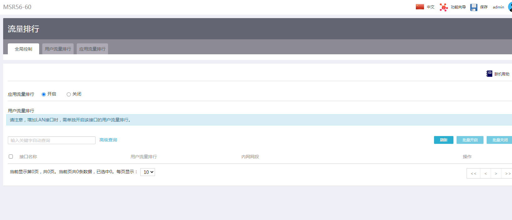

MSR5660路由器配置里已经配置了:
 session statistics enable
 session alarm usage-abrupt enable
 session alarm rate-abrupt enable
 session synchronization enable
可以显示应用流量排行,但无法显示用户流量排行。
看下lan接口下有没有单独开启流量统计排行

这台路由器没有设WAN和LAN,是在每个接口上配置。
是在每个接口上做下面配置吗?
 session log enable ipv4 inbound
session log enable ipv4 outbound
接口配置如下:
interface Ten-GigabitEthernet3/0/2
 port link-mode route
 duplex full
 speed 10000
interface Ten-GigabitEthernet3/0/2.100
 ip address 10.32.2.1 255.255.254.0
 ip address 10.32.0.1 255.255.255.0 sub
 local-proxy-arp enable
 packet-filter 3333 inbound
 vlan-type dot1q vid 100
interface Ten-GigabitEthernet3/0/3
 speed 10000
 ip address 10.32.4.1 255.255.255.0
interface Ten-GigabitEthernet3/0/4
 speed 10000
 interface Ten-GigabitEthernet3/0/4.1040
 ip address 10.32.96.1 255.255.255.0
 vlan-type dot1q vid 1040
