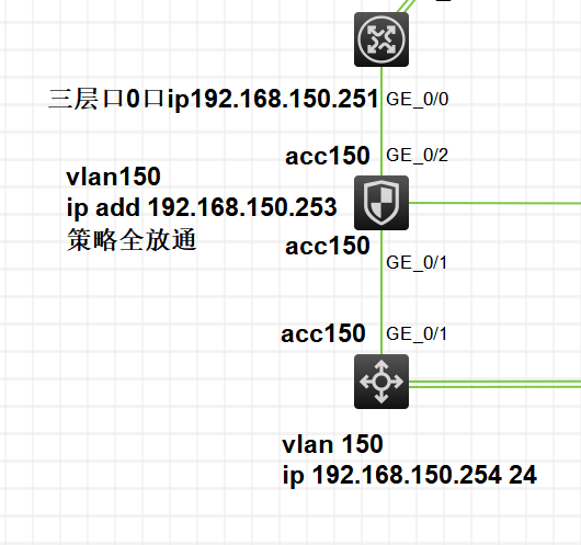

为什么我交换机还是ping不通路由器  251
2口接的核心
3口接的路由器
段
粉丝:人 关注:人

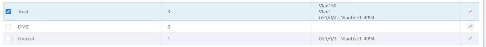

直接复制上去就行,可能是你的策略和安全域没有配置对,对应的安全域和接口要import 接口和vlan
vlan 150
description guanli
interface Vlan-interface150
ip address 192.168.150.253 255.255.255.0
interface GigabitEthernet 1/0/2
port link-mode bridge
port access vlan 150
security-zone name Untrust
import interface GigabitEthernet1/0/2 vlan 1 to 4094
interface GigabitEthernet 1/0/1
security-zone name Trust
import interface GigabitEthernet1/0/1 vlan 1 to 4094
security-policy ip
rule 100 name Trust-Untrust
action pass
logging enable
counting enable
source-zone Trust
destination-zone Untrust
rule 200 name Untrust-Trust
action pass
logging enable
counting enable
source-zone Untrust
destination-zone Trust
rule 300 name Trust-Local
action pass
logging enable
counting enable
source-zone Trust
destination-zone Local
rule 400 name Local-Trust
action pass
source-zone Local
rule 500 name Untrust-Local
action pass
logging enable
counting enable
source-zone Untrust
rule 600 name Local-Untrust
action pass
logging enable
counting enable
source-zone Local
两个设备的接口类型一致就行

如果我还有其他vlan要上网的话还需要加什么吗
zhiliao_SI5CzD 发表时间:2022-11-10
不需要加,你也可以把接口配成trunk 模式,允许所有vlan 通过
发表时间:2022-11-10
回复:
防火墙对接核心的口吗 那核心需要改acc还是trunk
两个设备的接口类型一致就行
发表时间:2022-11-10
相应接口加到安全域并且安全策略放通就可以通了
