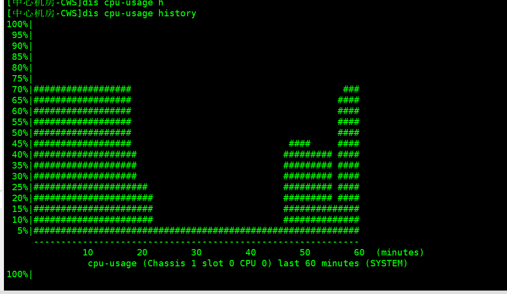

核心交换机没有跑任何业务CPU使用过高,大佬救命!
2022-11-19提问
  • 0收藏,2950浏览

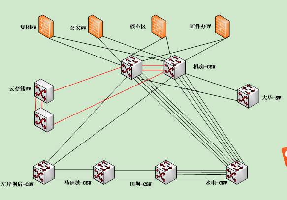

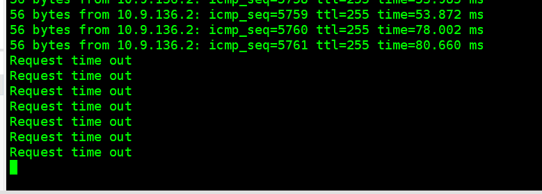

cpu使用率过高,长ping出现掉包,这是一个5台核心形成的环网
%Nov 19 17:13:09:514 2022 中心机房-CWS ARP/6/ARP_PKTQUE_ALERT: -MDC=1-Chassis=1-Slot=0; The current size of the ARP_PKT queue has reached 65532. Please check the network environment. %Nov 19 17:13:29:583 2022 中心机房-CWS ARP/6/ARP_PKTQUE_ALERT: -MDC=1-Chassis=2-Slot=0; The current size of the ARP_PKT queue has reached 65536. Please check the network environment. %Nov 19 17:14:01:321 2022 中心机房-CWS DRVPLAT/4/SOFTCAR RECOVER: -MDC=1-Chassis=2-Slot=0; Cos=15 %Nov 19 17:14:10:162 2022 中心机房-CWS ARP/6/ARP_PKTQUE_ALERT: -MDC=1-Chassis=1-Slot=0; The current size of the ARP_PKT queue has reached 65381. Please check the network environment. %Nov 19 17:14:29:777 2022 中心机房-CWS ARP/6/ARP_PKTQUE_ALERT: -MDC=1-Chassis=2-Slot=0; The current size of the ARP_PKT queue has reached 65451. Please check the network environment.
