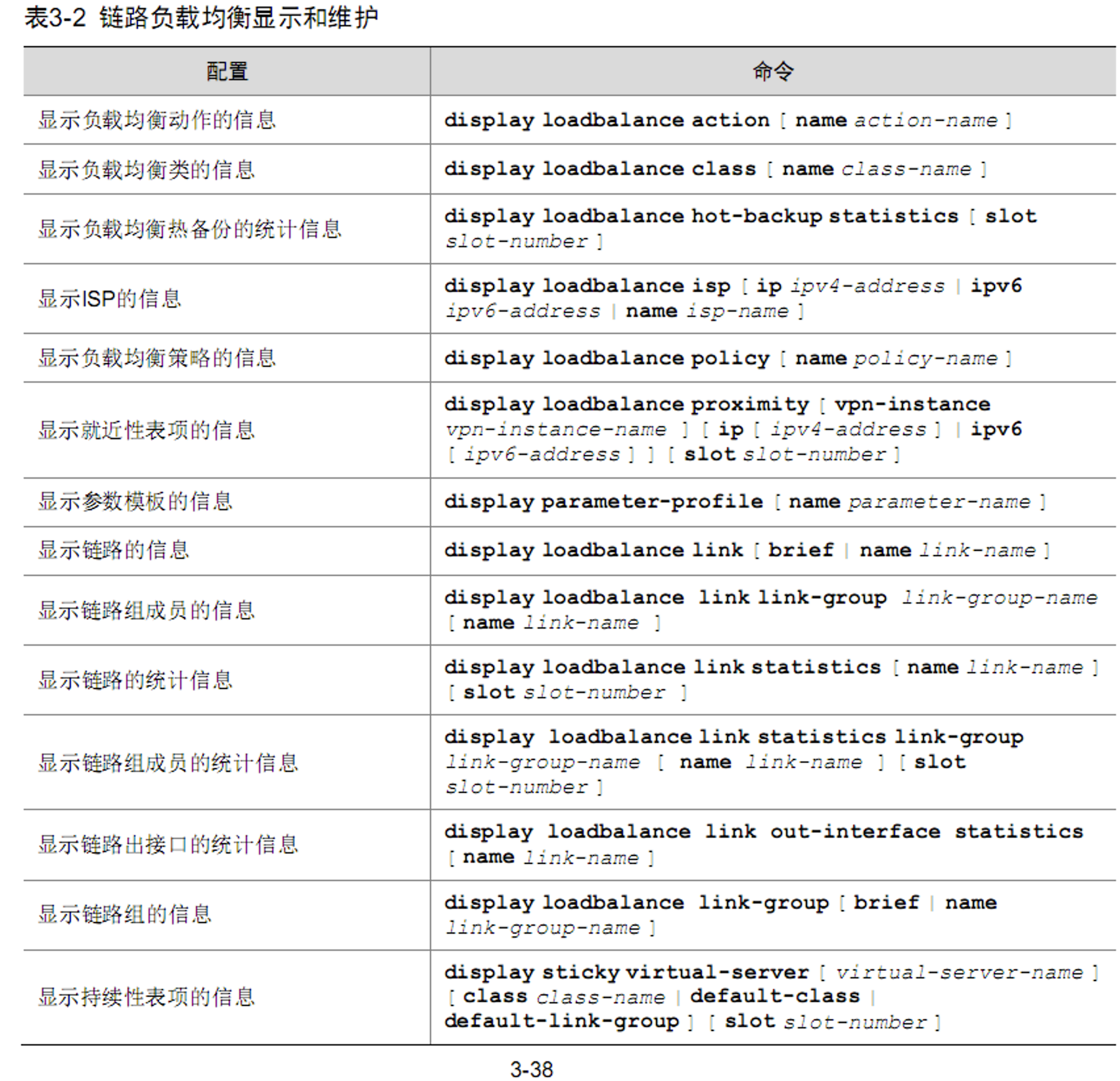

问题2,如何查看,链路下,哪些源地址是从哪条链路出去?
           貌似只能看到接口流量统计。
           Loadbalance link: dialer1 Input rate: 0 bps Output rate: 0 bps
           Loadbalance link: dialer2 Input rate: 0 bps Output rate: 0 bps
           Loadbalance link: dialer3 Input rate: 2464 bps Output rate: 2992 bps
