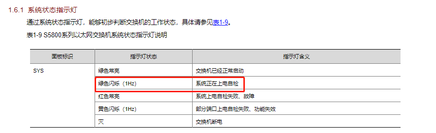

H3C s5800 交换机,unit显示1,sys指示灯绿灯闪烁,交换机所有网线接口均无闪烁,网络中断。

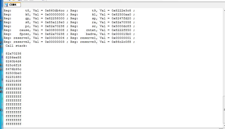

console口连上看看打印
建议连接console看下交换机状态。
unit表示当前交换机的Member ID

请把所有回显都发出来看看,这个截图没有什么有用的信息。
设备无法启动一般是版本文件丢失或者硬件故障,如果能到ctrl+B,可以进boot界面重新上传一下版本文件,如果进不了大概率硬件故障了,只能返修或者更换。

Starting...... Press Ctrl+D to access BASIC BOOT MENU Press Ctrl+T to start heavy memory test ******************************************************************************** * * * H3C S5800-56C BOOTROM, Version 220 * * * ******************************************************************************** Copyright (c) 2004-2012 Hangzhou H3C Technologies Co., Ltd. Creation Date : Dec 20 2012,15:36:45 CPU Clock Speed : 750MHz Memory Size : 1024MB Flash Size : 512MB CPLD Version : 003 PCB Version : Ver.C Mac Address : 70BAEF6CB476 Press Ctrl-B to enter Extended Boot menu...0 Starting to get the main application file--flash:/S5800_5820X-CMW520-R1808P12.bin!................................... ................................................................................ ................................................................................ ............................................. The main application file is self-decompressing................................. ................................................................................ ................................................................................ ....................................Done! The application file is self-decompressing...................................... ................................................................................ ................................................................................ ................................................................................ ................................................................................ ................................................................................ ................................................................................ ................................................................................ ................................................................................ ................................................................................ ................................................................................ ................................................................................ ................................................................................ ................................................................................ ................................................................................ ................................................................................ ................................................................................ ................................................................................ ................................................................................ ................................................................................ ................................................................................ ................................................................................ ................................................................................ ................................................................................ ................................................................................ ................................................................................ ................................................................................ ................................................................................ ................................................................................ ................................................................................ ................................................................................ ............................................................................... Done! System is starting... Call function: bcm_stk_my_modid_set ulunitid=1,usmymod=6, return value is -3 Exception Exception Number: 0x02 Exception Name: TLB miss exception (load or instruction fetch) Exception Instruction: 0x82A70238 Exception Slot: 0 Exception Task: N/A (TID: -1) Exception Stack Base: 0xffffffff Exception Stack Top: 0x8247fd20 Exception Time: 2000-04-26 12:00:12 Exception Tick: 0x0(CPU Tick High) 0x4094ef6a(CPU Tick Low) Register contents: Reg: zero, Val = 0x00000000 ; Reg: at, Val = 0x5000dc80 ; Reg: v0, Val = 0x00000000 ; Reg: v1, Val = 0x86c2c0fc ; Reg: a0, Val = 0x00000003 ; Reg: a1, Val = 0x00000000 ; Reg: a2, Val = 0x8247fcb8 ; Reg: a3, Val = 0x00000001 ; Reg: t0, Val = 0x00000006 ; Reg: t1, Val = 0xea001008 ; Reg: t2, Val = 0x00000001 ; Reg: t3, Val = 0x00000001 ; Reg: t4, Val = 0x00000001 ; Reg: t5, Val = 0x00000000 ; Reg: t6, Val = 0x00000000 ; Reg: t7, Val = 0x00000001 ; Reg: s0, Val = 0x00000000 ; Reg: s1, Val = 0x00000000 ; Reg: s2, Val = 0x00000004 ; Reg: s3, Val = 0x00000001 ; Reg: s4, Val = 0x00000003 ; Reg: s5, Val = 0x86c2c0f8 ; Reg: s6, Val = 0x85a10ca8 ; Reg: s7, Val = 0x859adacc ; Reg: t8, Val = 0x860db4cc ; Reg: t9, Val = 0x8222e3c8 ; Reg: k0, Val = 0x00000000 ; Reg: k1, Val = 0x82500aa0 ; Reg: gp, Val = 0x82258000 ; Reg: sp, Val = 0x8247fd20 ; Reg: s8, Val = 0x85a118e0 ; Reg: ra, Val = 0x82a70558 ; Reg: pc, Val = 0x82a70238 ; Reg: sr, Val = 0x5000dc83 ; Reg: cause, Val = 0x00800008 ; Reg: cntxt, Val = 0x8222f850 ; Reg: fpcsr, Val = 0x82a70238 ; Reg: badva, Val = 0x000015b0 ; Reg: reserve0, Val = 0x00000004 ; Reg: reserve1, Val = 0x00000001 ; Reg: reserve2, Val = 0x00000003 ; Reg: reserve3, Val = 0x86c2c0f8 ; Call stack: 82a70238 8286ee88 8260b4d4 825c6f18 8476b95c 82500be0 82231680 82231608 ffffffff ffffffff ffffffff ffffffff ffffffff ffffffff ffffffff ffffffff ffffffff ffffffff ffffffff

回复zhiliao_53792:
看回显是在版本文件加载之后,设备开始启动后才开始报错的,返修吧
