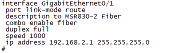

其中的一个WAN口GE0/1,删除了ACL策略, MSR830  重启  后端口自动应用了ACL策略,怎么让不自动应用策略.

保存后查看一下配置文件的内容
zhiliao_sEUyB 发表时间:2022-12-27
interface GigabitEthernet0/0 port link-mode route description to 4G router firewall packet-filter 4998 outbound nat outbound ip address 192.168.0.4 255.255.255.0 qos apply policy PolicyLimit outbound web-redirect url 127.0.0.1:8080 interval 60 dns server 218.202.3.3 dns server 218.202.4.4 ip flow-ordering external # interface GigabitEthernet0/1 port link-mode route description to MSR830-2 Fiber combo enable fiber duplex full speed 1000 ip address 192.168.2.1 255.255.255.0 #配置文件GE0/1里面也没有配置规则.

save一下,然后重启后,如果配置又回来了,那么再看看配置文件内容和配置文件的时间

interface GigabitEthernet0/1 port link-mode route description to MSR830-2 Fiber firewall packet-filter 4998 outbound combo enable fiber duplex full speed 1000 ip address 192.168.2.1 255.255.255.0 SAVE 重启后自动应用规则,其他的配置保存后没有丢失.
