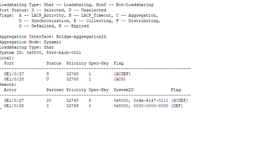

5800配置:
interface GigabitEthernet1/0/8
 port link-mode bridge
 port link-type trunk
 port trunk permit vlan 1 99 731 850 2361
 broadcast-suppression 1
 port link-aggregation group 20
interface GigabitEthernet1/0/20
interface Bridge-Aggregation20
 link-aggregation mode dynamic
5500配置:
interface GigabitEthernet1/0/27
 port trunk permit vlan all
 port link-aggregation group 24
interface GigabitEthernet1/0/28
interface Bridge-Aggregation24
目前链路聚合状态如附件图片。
端口defaulted状态?
检查一下链路模块问题,没问题的话 同步一下两端聚合口的配置
