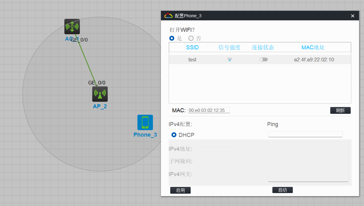

模拟器为什么ap都在线了,在phone看不到wifi信号,模拟器版本V5.7

radio enable打了吗?
开启了射频的话AP边上应该有个圆形的覆盖范围。
如果radio enable以后没有那个圆,尝试保存配置重启。

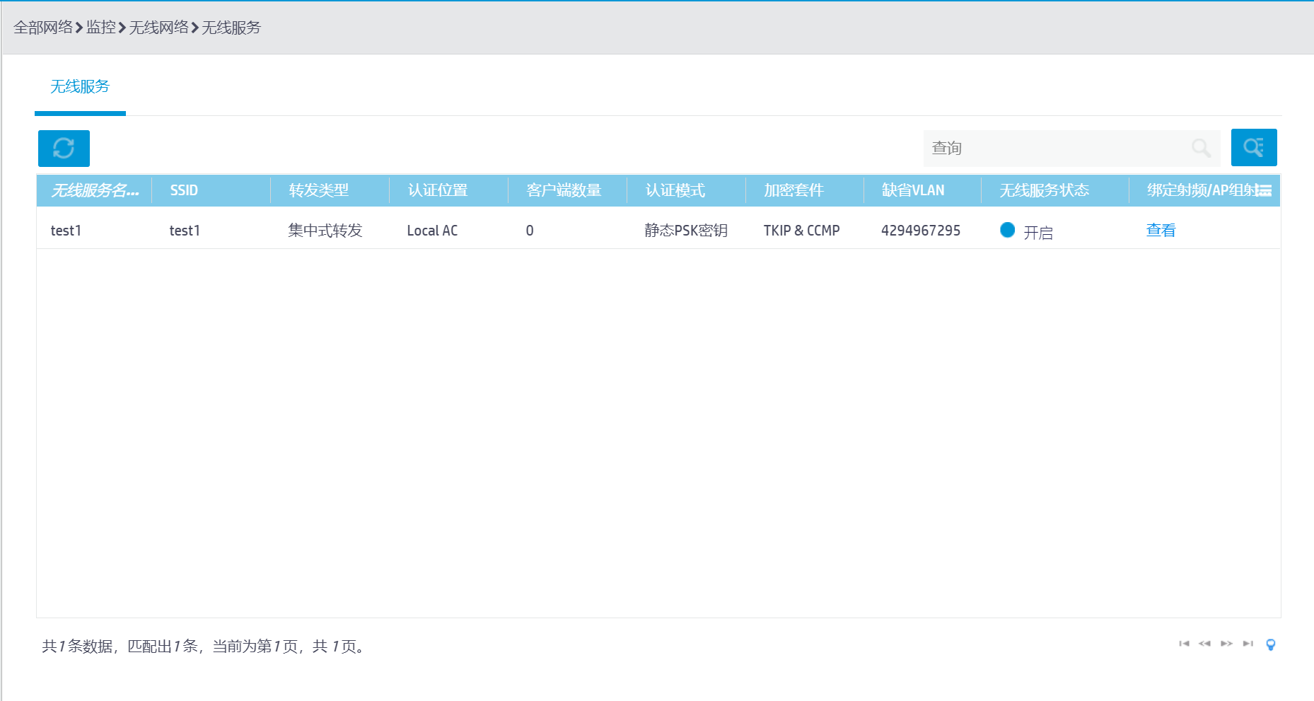

服务模板在射频下调用了吗?射频开启了吗?
开启了,调用了
打工皇帝 发表时间:2023-01-28 更多>>
开启了,调用了

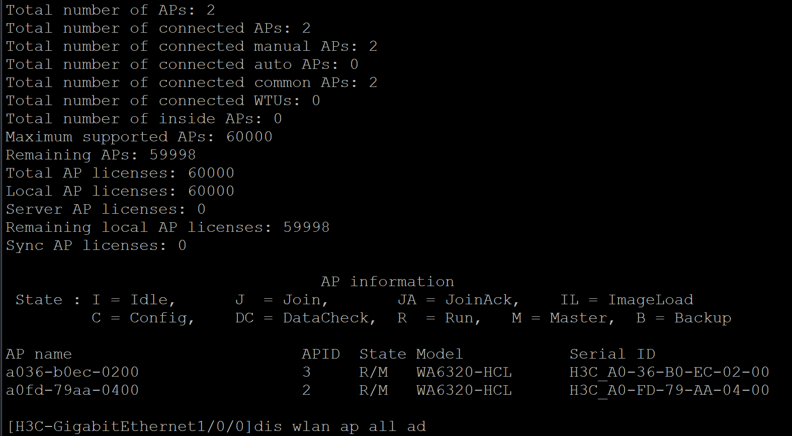

dis wlan ap all radio看看
[H3C]dis wlan ap all radio Total number of APs: 2 Total number of connected APs: 1 Total number of connected manual APs: 1 Total number of connected auto APs: 0 Total number of connected common APs: 1 Total number of connected WTUs: 0 Total number of inside APs: 0 Maximum supported APs: 60000 Remaining APs: 59999 Total AP licenses: 60000 Local AP licenses: 60000 Server AP licenses: 0 Remaining local AP licenses: 59999 Sync AP licenses: 0 AP name RID State Channel BW Usage TxPower Clients (MHz) (%) (dBm) a036-b0ec-0200 1 Down 52(auto) 80 0 20 0 a036-b0ec-0200 2 Down 11(auto) 20 0 20 0 a0fd-79aa-0400 1 Down 52(auto) 80 0 20 0 a0fd-79aa-0400 2 Down 6(auto) 20 0 20 0 [H3C]
