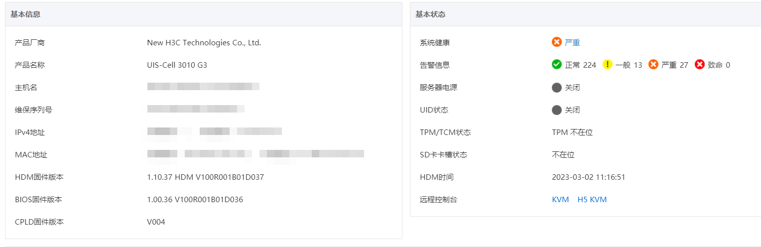

UIS-Cell 3010 G3 无法开机报错
2023-03-02提问
  • 0收藏,2891浏览
OverCurrent current 触发 严重 State asserted
PSU1_Status power_supply 触发 严重 Power supply input out-of-range - but present
PSU1_Status power_supply 触发 严重 Power supply input lost (AC/DC)
CPU1_VDDQ2_PG voltage 触发 严重 State asserted
CPU1_VDDQ1_PG voltage 触发 严重 State asserted
CPLD oem 触发 严重 DIMM(Belong to CPU0) power failure detected by CPLD---Diagnostic register location:0x6c---Diagnostic register value:0x30
CPLD oem 触发 严重 CPU0 hardware failure detected by CPLD---Diagnostic register location:0x6a---Diagnostic register value:0xc
CPLD oem 触发 严重 General hardware failure detected by CPLD---Diagnostic register location:0x65---Diagnostic register value:0x54

通过报错看,应和外部供电有关,能否确认输入电压是否正常?
zhiliao_UsW4dy 知了小白
电压正常
粉丝:6人 关注:35人
通过日志信息是硬件存在故障,建议拨打400热线报修处理
粉丝:48人 关注:2人
大概率是主板有问题了,可以尝试拆卸CPU试一下
