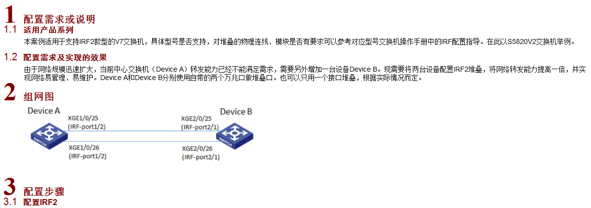

3.1.1  配置设备编号
# Device A保留缺省编号为1,不需要进行配置。同时,在Device B上将设备的成员编号修改为2。
<DeviceB> system-view   //进入系统视图
[DeviceB] irf member 1 renumber 2   //将设备的成员编号修改为2
Warning: Renumbering the switch number may result in configuration change or loss. Continue? [Y/N]:y
[DeviceB]
3.1.2  配置堆叠口
#将两台设备断电后,按组网图所示连接IRF链路,然后将两台设备上电。在Device A上创建设备的IRF端口2,与物理端口Ten-GigabitEthernet1/0/25、 Ten-GigabitEthernet1/0/26绑定,并保存配置。
<DeviceA> system-view   //进入系统视图
[DeviceA] interface ten-gigabitethernet 1/0/25   //进入xg1/0/25接口
[DeviceA-Ten-GigabitEthernet1/0/25] shutdown   //关闭接口
[DeviceA-Ten-GigabitEthernet1/0/25] quit   //退出当前视图
[DeviceA] interface ten-gigabitethernet 1/0/26   //进入xg1/0/26接口
[DeviceA-Ten-GigabitEthernet1/0/26] shutdown   //关闭接口
[DeviceA-Ten-GigabitEthernet1/0/26] quit   //退出当前视图
[DeviceA] irf-port 1/2   //进入irf端口1/2
[DeviceA-irf-port1/2] port group interface ten-gigabitethernet1/0/25   //将成员设备1的IRF物理端口Ten-GigabitEthernet1/0/25和IRF端口IRF-port2绑定
[DeviceA-irf-port1/2] port group interface ten-gigabitethernet1/0/26   //将成员设备1的IRF物理端口Ten-GigabitEthernet1/0/26和IRF端口IRF-port2绑定
[DeviceA-irf-port1/2] quit   //退出当前视图
[DeviceA-Ten-GigabitEthernet1/0/25] undo shutdown   //开启接口
[DeviceA-Ten-GigabitEthernet1/0/26] undo shutdown   //开启接口
[DeviceA] save force   //保存配置
# 在Device B上创建设备的IRF端口1,与物理端口Ten-GigabitEthernet2/0/25、Ten-GigabitEthernet2/0/26绑定,并保存配置。
[DeviceB] interface ten-gigabitethernet 2/0/25   //进入xg2/0/25接口
[DeviceB-Ten-GigabitEthernet2/0/25] shutdown   //关闭接口
[DeviceB-Ten-GigabitEthernet2/0/25] quit   //退出当前视图
[DeviceB] interface ten-gigabitethernet 2/0/26   //进入xg2/0/26接口
[DeviceB-Ten-GigabitEthernet2/0/26] shutdown   //关闭接口
[DeviceB-Ten-GigabitEthernet2/0/26] quit   //退出当前视图
[DeviceB] irf-port 2/1   //进入irf端口2/1
[DeviceB-irf-port2/1] port group interface ten-gigabitethernet2/0/25   //将成员设备2的IRF物理端口Ten-GigabitEthernet2/0/25和IRF端口IRF-port1绑定
[DeviceB-irf-port2/1] port group interface ten-gigabitethernet2/0/26   //将成员设备2的IRF物理端口Ten-GigabitEthernet2/0/26和IRF端口IRF-port1绑定
[DeviceB-irf-port2/1] quit   //退出当前视图
[DeviceB-Ten-GigabitEthernet2/0/25] undo shutdown   //开启接口
[DeviceB-Ten-GigabitEthernet2/0/26] undo shutdown   //开启接口
[DeviceB] save force   //保存配置
# 激活DeviceA的IRF端口配置。
[DeviceA] irf-port-configuration active   //激活DeviceA的IRF端口配置
# 激活DeviceB的IRF端口配置。
[DeviceB] irf-port-configuration active   //激活DeviceB的IRF端口配置
#两台设备间将会进行Master竞选,竞选失败的一方将自动重启,重启完成后,IRF形成,系统名称统一为DeviceA

3.2.9 V7 交换机IRF2堆叠配置方法(命令行版)以下是盒式设备的irf典配:
配置IRF2
3.1.1  配置设备编号
[DeviceB]
3.1.2  配置堆叠口
