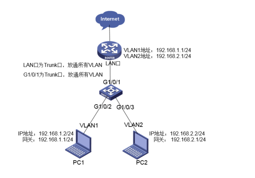

1.2配置需求及实现的效果
MSR路由器作为下面两个网段,192.168.1.0/24网段和192.168.2.0/24网段的网关。将路由器的G0/0口与交换机G1/0/1口相连,在路由器G0/0上创建虚地址;交换机与路由器的互连接口都配置成trunk口,并放通vlan2通过。交换机的G1/0/2接PC1,G1/0/3接PC2,要求PC1和PC2可以访问互联网(访问路由器的网关)。
2.    组网图
3.    配置步骤
3.1路由器端配置
#创建vlan
<H3C> system-view
[H3C] interface vlan 2
#配置虚接口地址,作为PC的网关
[H3C]interface  Vlan-interface 1
[H3C-Vlan-interface1] ip address 192.168.1.1 24
[H3C-Vlan-interface1] interface Vlan-interface 2
[H3C-Vlan-interface2]ip address 192.168.2.1 24
[H3C-Vlan-interface2]quit
#将与交换机互连的接口配置成trunk口,并放通所有vlan
[H3C]interface GigabitEthernet 0/2
[H3C-GigabitEthernet0/2]port link-type trunk
[H3C-GigabitEthernet0/2]port trunk  permit vlan all
#保存配置
[H3C]save force
3.2交换机端的配置
#创建vlan
<H3C>system-view
[H3C]interface vlan 2
#将连接路由器的接口切换成trunk口,并放通所有vlan
[H3C]interface  GigabitEthernet 1/0/1
[H3C-GigabitEthernet1/0/1]port link-type trunk
[H3C-GigabitEthernet1/0/1]port trunk permit vlan all
[H3C-GigabitEthernet1/0/1]quit
#将连接PC1和PC2接口划分到相应的vlan中
[H3C]interface GigabitEthernet 1/0/2
[H3C-GigabitEthernet1/0/2] port access vlan 1
[H3C-GigabitEthernet1/0/2] interface GigabitEthernet 1/0/3
[H3C-GigabitEthernet1/0/2] port access vlan 2
#保存配置
[H3C]save force
