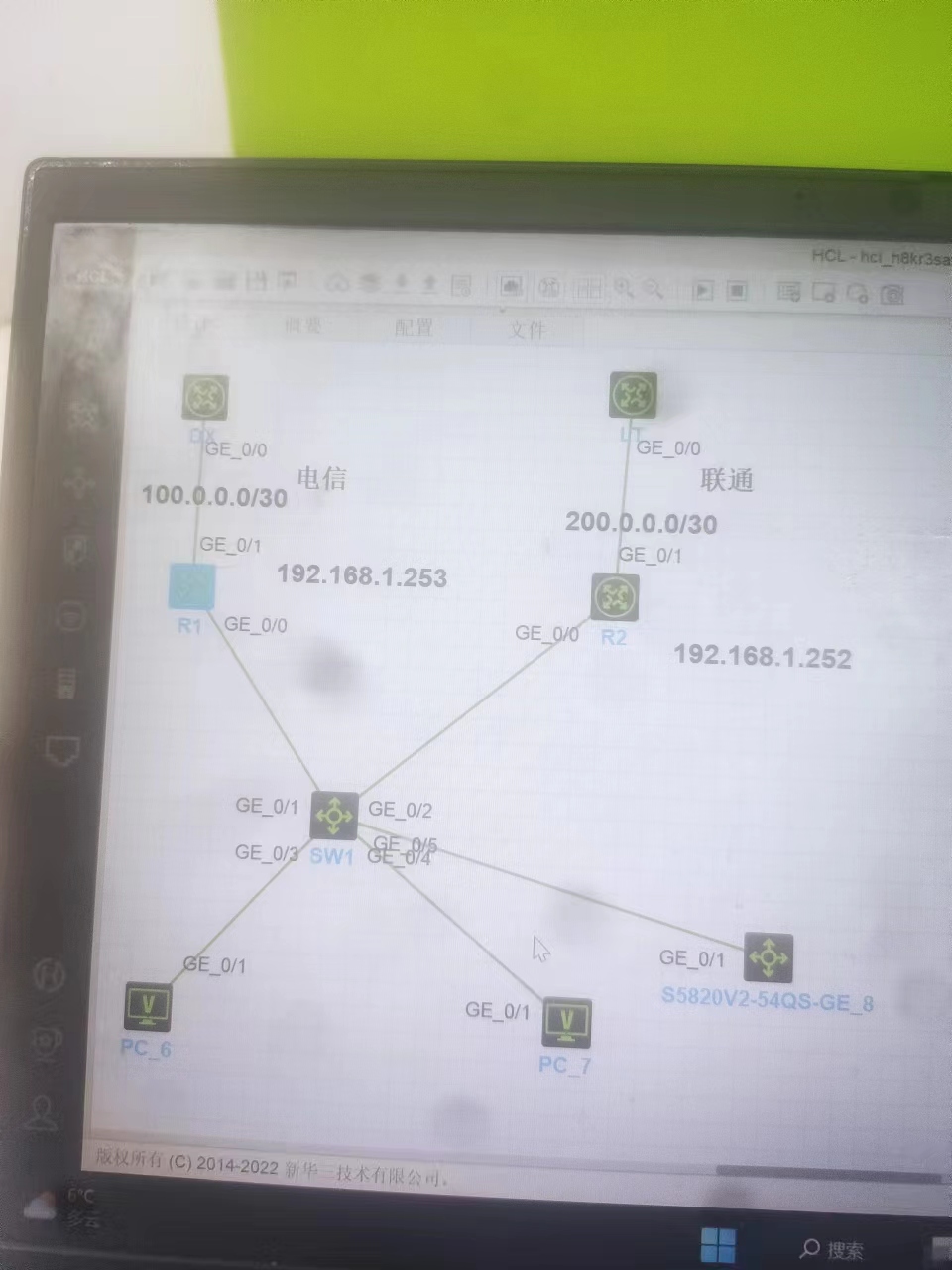

两台出口路由器分别连接电信,联通,出口配置VRRP,master在电信出口上,当主master挂掉,切换到联通出口,电信出口接口配置nat server global 100.0.0.1 inside 192.168.1.6后,主master会挂掉,master切换到联通,
[H3C-GigabitEthernet0/1]%Mar 16 20:21:26:016 2023 H3C BFD/5/BFD_CHANGE_FSM: Sess[100.0.0.1/100.0.0.2, LD/RD:33793/33793, Interface:GE0/1, SessType:Echo, LinkType:INET], Ver:1, Sta: UP->DOWN, Diag: 2 (Echo Function Failed) [H3C-GigabitEthernet0/1] [H3C-GigabitEthernet0/1]%Mar 16 20:21:26:824 2023 H3C VRRP4/6/VRRP_STATUS_CHANGE: The status of IPv4 virtual router 1 (configured on GigabitEthernet0/0) changed from Master to Backup: VRRP packet received.
但是我要是配置nat  server  规定端口,就可以正常使用,有大佬知道不限制端口情况下为什么造成主备切换吗。

猜测:nat server没指定端口,端口全映射,echo回声检测环回的报文直接优先匹配了nat server策略,没有去做本地的连通性检测。echo报文目的端口UDP3785,试下是不是只要不映射这个端口,就没问题。
