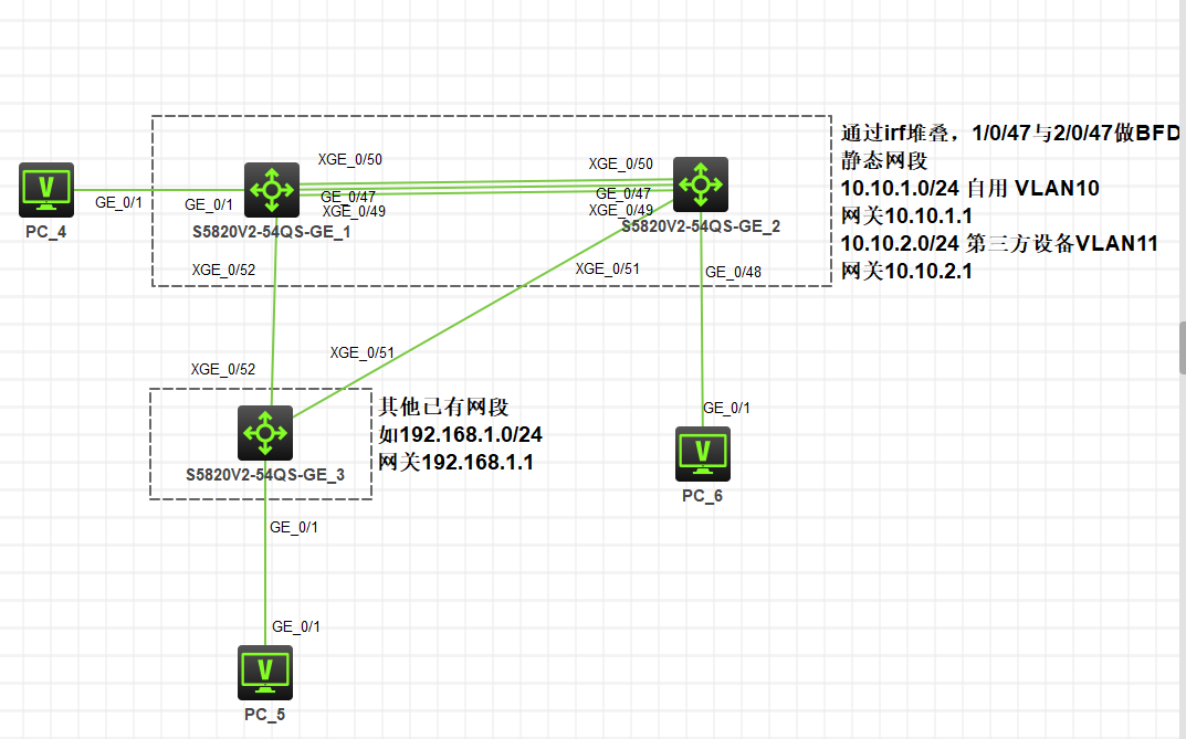

S5820v2-54QS-GE_1与S5820v2-54QS-GE_2做堆叠,然后与S5820v2-54QS-GE_3做端口聚合链接 PC4,PC5互访 正常 。PC5,PC6互访丢包。
筱坏 七段
粉丝:8人 关注:0人
是实际组网还是做的实验?如果是实验的话可以把那根线删了重连一下,有bug的
[DeviceA]dis current-configuration
version 7.1.075, Alpha 7571
sysname DeviceA
irf mac-address persistent timer
irf auto-update enable
undo irf link-delay
irf member 1 priority 1
irf member 2 priority 1
lldp global enable
system-working-mode standard
xbar load-single
password-recovery enable
lpu-type f-series
vlan 1
vlan 10 to 11
vlan 200
irf-port 1/2
port group interface Ten-GigabitEthernet1/0/49
port group interface Ten-GigabitEthernet1/0/50
irf-port 2/1
port group interface Ten-GigabitEthernet2/0/49
port group interface Ten-GigabitEthernet2/0/50
stp global enable
interface Bridge-Aggregation1
port link-type trunk
port trunk permit vlan all
interface NULL0
interface Vlan-interface1
ip address 172.31.1.100 255.255.255.0
interface Vlan-interface10
ip address 10.10.1.1 255.255.255.0
interface Vlan-interface11
ip address 10.10.2.1 255.255.255.0
interface Vlan-interface200
mad bfd enable
mad ip address 100.100.2.1 255.255.255.0 member 1
mad ip address 100.100.2.2 255.255.255.0 member 2

port access vlan 11
combo enable fiber
interface GigabitEthernet2/0/42
port link-mode bridge
port access vlan 11
combo enable fiber
interface GigabitEthernet2/0/43
port access vlan 11
combo enable fiber
interface GigabitEthernet2/0/44
port access vlan 11
combo enable fiber
interface GigabitEthernet2/0/45
port access vlan 11
combo enable fiber
interface GigabitEthernet2/0/46
port access vlan 11
combo enable fiber
interface GigabitEthernet2/0/47
port access vlan 200
combo enable fiber
undo stp enable
interface GigabitEthernet2/0/48
port access vlan 11
combo enable fiber
interface M-GigabitEthernet0/0/0
interface Ten-GigabitEthernet1/0/51
combo enable fiber
interface Ten-GigabitEthernet1/0/52
combo enable fiber
port link-aggregation group 1
interface Ten-GigabitEthernet2/0/51
combo enable fiber
interface Ten-GigabitEthernet2/0/52
combo enable fiber
combo enable fiber
combo enable fiber
combo enable fiber
combo enable fiber
scheduler logfile size 16
line class aux
user-role network-operator
line class console
user-role network-admin
line class tty
line class vty
line aux 0 1
line con 0 1
line vty 0 63
ip route-static 192.168.1.0 24 Vlan-interface1 172.31.1.110
radius scheme system
user-name-format without-domain
domain name system
domain default enable system
role name level-0
description Predefined level-0 role
role name level-1
description Predefined level-1 role
role name level-2
description Predefined level-2 role
role name level-3
description Predefined level-3 role
role name level-4
description Predefined level-4 role
role name level-5
description Predefined level-5 role
role name level-6
description Predefined level-6 role
role name level-7
description Predefined level-7 role
role name level-8
description Predefined level-8 role
role name level-9
description Predefined level-9 role
role name level-10
description Predefined level-10 role
role name level-11
description Predefined level-11 role
role name level-12
description Predefined level-12 role
role name level-13
description Predefined level-13 role
role name level-14
description Predefined level-14 role
user-group system
ip http enable
ip https enable
return
[QT]dis current-configuration # version 7.1.075, Alpha 7571 # sysname QT # irf mac-address persistent timer irf auto-update enable undo irf link-delay irf member 1 priority 1 # lldp global enable # system-working-mode standard xbar load-single password-recovery enable lpu-type f-series # vlan 1 # vlan 10 to 11 # vlan 100 # stp global enable # interface Bridge-Aggregation1 port link-type trunk port trunk permit vlan all # interface NULL0 # interface Vlan-interface1 ip address 172.31.1.110 255.255.255.0 # interface Vlan-interface100 ip address 192.168.1.1 255.255.255.0 # interface FortyGigE1/0/53 port link-mode bridge # interface FortyGigE1/0/54 port link-mode bridge # interface GigabitEthernet1/0/1 port link-mode bridge port access vlan 100 combo enable fiber # interface GigabitEthernet1/0/2 port link-mode bridge port access vlan 100 combo enable fiber # interface GigabitEthernet1/0/3 port link-mode bridge port access vlan 100 combo enable fiber # interface GigabitEthernet1/0/4 port link-mode bridge port access vlan 100 combo enable fiber # interface GigabitEthernet1/0/5 port link-mode bridge port access vlan 100 combo enable fiber # interface GigabitEthernet1/0/6 port link-mode bridge port access vlan 100 combo enable fiber # interface GigabitEthernet1/0/7 port link-mode bridge port access vlan 100 combo enable fiber # interface GigabitEthernet1/0/8 port link-mode bridge port access vlan 100 combo enable fiber # interface GigabitEthernet1/0/9 port link-mode bridge port access vlan 100 combo enable fiber # interface GigabitEthernet1/0/10 port link-mode bridge port access vlan 100 combo enable fiber # interface GigabitEthernet1/0/11 port link-mode bridge port access vlan 100 combo enable fiber # interface GigabitEthernet1/0/12 port link-mode bridge port access vlan 100 combo enable fiber # interface GigabitEthernet1/0/13 port link-mode bridge port access vlan 100 combo enable fiber # interface GigabitEthernet1/0/14 port link-mode bridge port access vlan 100 combo enable fiber # interface GigabitEthernet1/0/15 port link-mode bridge port access vlan 100 combo enable fiber # interface GigabitEthernet1/0/16 port link-mode bridge port access vlan 100 combo enable fiber # interface GigabitEthernet1/0/17 port link-mode bridge port access vlan 100 combo enable fiber # interface GigabitEthernet1/0/18 port link-mode bridge port access vlan 100 combo enable fiber # interface GigabitEthernet1/0/19 port link-mode bridge port access vlan 100 combo enable fiber # interface GigabitEthernet1/0/20 port link-mode bridge port access vlan 100 combo enable fiber # interface GigabitEthernet1/0/21 port link-mode bridge port access vlan 100 combo enable fiber # interface GigabitEthernet1/0/22 port link-mode bridge port access vlan 100 combo enable fiber # interface GigabitEthernet1/0/23 port link-mode bridge port access vlan 100 combo enable fiber # interface GigabitEthernet1/0/24 port link-mode bridge port access vlan 100 combo enable fiber # interface GigabitEthernet1/0/25 port link-mode bridge port access vlan 100 combo enable fiber # interface GigabitEthernet1/0/26 port link-mode bridge port access vlan 100 combo enable fiber # interface GigabitEthernet1/0/27 port link-mode bridge port access vlan 100 combo enable fiber # interface GigabitEthernet1/0/28 port link-mode bridge port access vlan 100 combo enable fiber # interface GigabitEthernet1/0/29 port link-mode bridge port access vlan 100 combo enable fiber # interface GigabitEthernet1/0/30 port link-mode bridge port access vlan 100 combo enable fiber # interface GigabitEthernet1/0/31 port link-mode bridge port access vlan 100 combo enable fiber # interface GigabitEthernet1/0/32 port link-mode bridge port access vlan 100 combo enable fiber # interface GigabitEthernet1/0/33 port link-mode bridge port access vlan 100 combo enable fiber # interface GigabitEthernet1/0/34 port link-mode bridge port access vlan 100 combo enable fiber # interface GigabitEthernet1/0/35 port link-mode bridge port access vlan 100 combo enable fiber # interface GigabitEthernet1/0/36 port link-mode bridge port access vlan 100 combo enable fiber # interface GigabitEthernet1/0/37 port link-mode bridge port access vlan 100 combo enable fiber # interface GigabitEthernet1/0/38 port link-mode bridge port access vlan 100 combo enable fiber # interface GigabitEthernet1/0/39 port link-mode bridge port access vlan 100 combo enable fiber # interface GigabitEthernet1/0/40 port link-mode bridge port access vlan 100 combo enable fiber # interface GigabitEthernet1/0/41 port link-mode bridge port access vlan 100 combo enable fiber # interface GigabitEthernet1/0/42 port link-mode bridge port access vlan 100 combo enable fiber # interface GigabitEthernet1/0/43 port link-mode bridge port access vlan 100 combo enable fiber # interface GigabitEthernet1/0/44 port link-mode bridge port access vlan 100 combo enable fiber # interface GigabitEthernet1/0/45 port link-mode bridge port access vlan 100 combo enable fiber # interface GigabitEthernet1/0/46 port link-mode bridge port access vlan 100 combo enable fiber # interface GigabitEthernet1/0/47 port link-mode bridge port access vlan 100 combo enable fiber # interface GigabitEthernet1/0/48 port link-mode bridge port access vlan 100 combo enable fiber # interface M-GigabitEthernet0/0/0 # interface Ten-GigabitEthernet1/0/49 port link-mode bridge combo enable fiber # interface Ten-GigabitEthernet1/0/50 port link-mode bridge combo enable fiber # interface Ten-GigabitEthernet1/0/51 port link-mode bridge combo enable fiber port link-aggregation group 1 # interface Ten-GigabitEthernet1/0/52 port link-mode bridge port link-type trunk port trunk permit vlan all combo enable fiber port link-aggregation group 1 # scheduler logfile size 16 # line class aux user-role network-operator # line class console user-role network-admin # line class tty user-role network-operator # line class vty user-role network-operator # line aux 0 user-role network-operator # line con 0 user-role network-admin # line vty 0 63 user-role network-operator # ip route-static 10.10.1.0 24 Vlan-interface1 172.31.1.100 ip route-static 10.10.2.0 24 Vlan-interface1 172.31.1.100 # radius scheme system user-name-format without-domain # domain name system # domain default enable system # role name level-0 description Predefined level-0 role # role name level-1 description Predefined level-1 role # role name level-2 description Predefined level-2 role # role name level-3 description Predefined level-3 role # role name level-4 description Predefined level-4 role # role name level-5 description Predefined level-5 role # role name level-6 description Predefined level-6 role # role name level-7 description Predefined level-7 role # role name level-8 description Predefined level-8 role # role name level-9 description Predefined level-9 role # role name level-10 description Predefined level-10 role # role name level-11 description Predefined level-11 role # role name level-12 description Predefined level-12 role # role name level-13 description Predefined level-13 role # role name level-14 description Predefined level-14 role # user-group system # return
模拟器bug,实际场景不会
