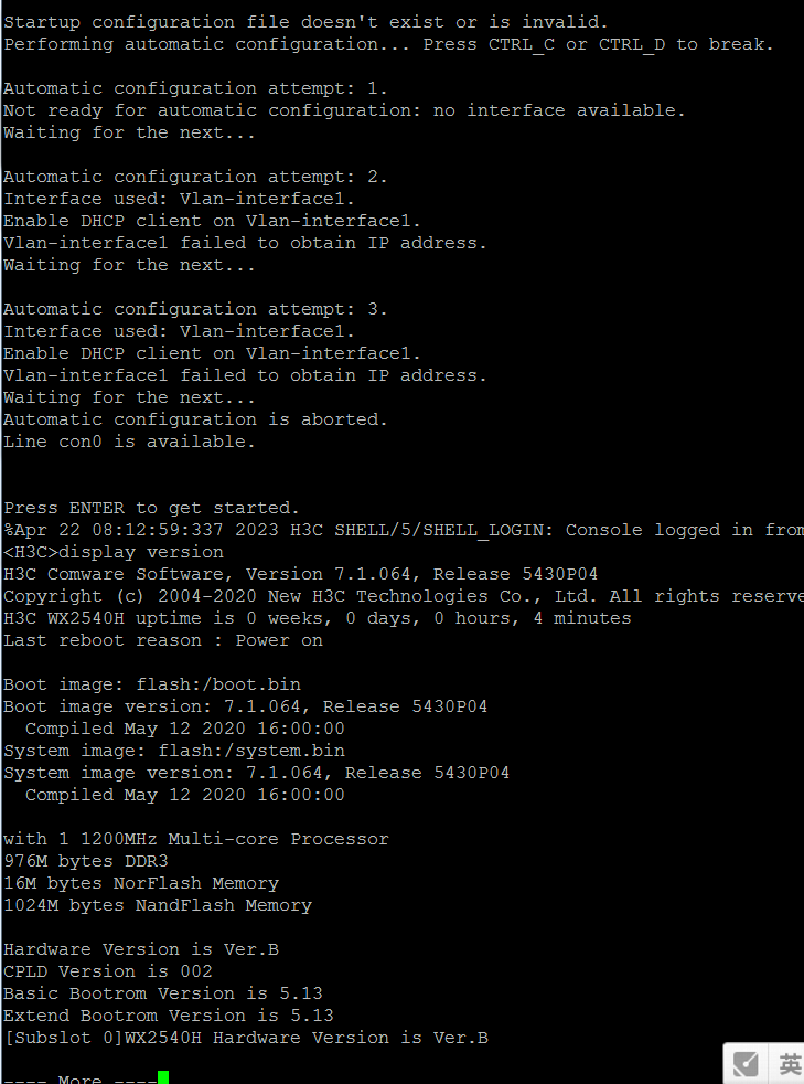

<H3C>disp current-configuration | include http server enable ^ % Too many parameters found at '^' position. <H3C> <H3C>disp current-configuration # version 7.1.064, Release 5430P04 # sysname H3C # wlan global-configuration # telnet server enable # lldp global enable # password-recovery enable # vlan 1 这个命令进不去

<H3C>dis cur # version 7.1.064, Release 5430P04 # sysname H3C # wlan global-configuration # telnet server enable # lldp global enable # password-recovery enable # vlan 1 # interface NULL0 # interface Vlan-interface1 ip address dhcp-alloc # interface GigabitEthernet1/0/5 port link-mode route # 没有显示ip
zhiliao_WVdafL 发表时间:2023-04-22
