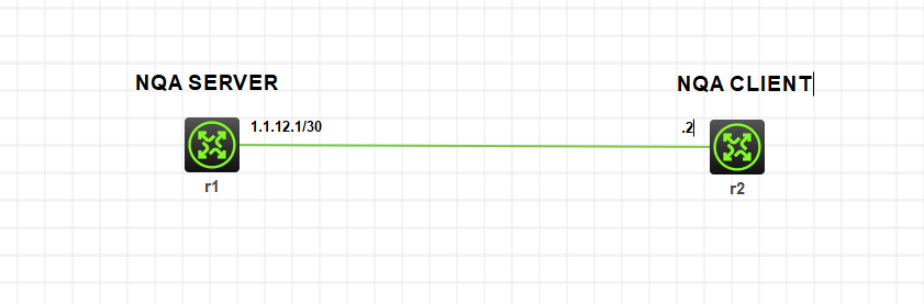

[r2]nqa agent enable
 [r2]%May 11 09:21:44:257 2023 r2 SCMD/5/PROCESS_ABNORMAL: The process nqad exited abnormally.
 [r2]nqa entry A 1
 [r2]%May 11 09:21:51:621 2023 r2 SCMD/5/PROCESS_ABNORMAL: The process nqad exited abnormally.
 [r2]
如下图配置nqa客户端 为啥 配不成功,提示进程异常退出
路由器型号不对 选vsr88配nqa就会报错,换一个就能配了

把nqa的配置贴上来吧
模拟器不稳定,重启一下 把内存跳转到512以上再试试
