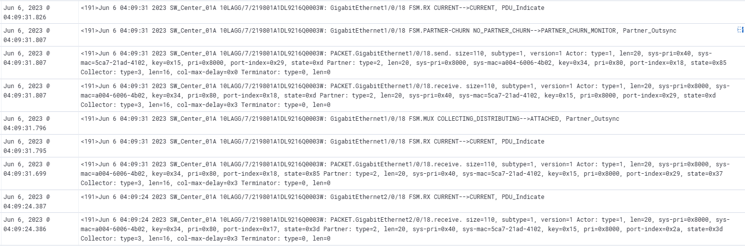

核心交换机debug日志:
  <191>Jun 6 04:09:31 2023 SW_Center_01A 10LAGG/7/219801A1DL9216Q0003W: PACKET.GigabitEthernet1/0/18.receive. size=110, subtype=1, version=1 Actor: type=1, len=20, sys-pri=0x8000, sys-mac=a004-6006-4b02, key=0x34, pri=0x80, port-index=0x18, state=0x85 Partner: type=2, len=20, sys-pri=0x40, sys-mac=5ca7-21ad-4102, key=0x15, pri=0x8000, port-index=0x29, state=0x37 Collector: type=3, len=16, col-max-delay=0x3 Terminator: type=0, len=0
【上述日志当state=0x85时好像就会出现同步失败问题】
state=0x85是什么意思,改如何处理这个故障,实在没啥头绪,请各位大佬帮忙看看。

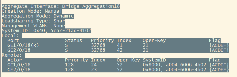

聚合组信息
核心交换机信息

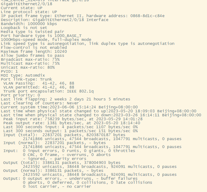

接口详情

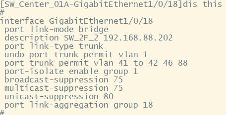

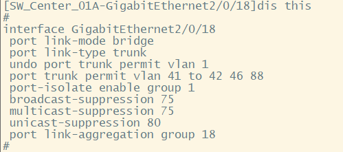

本端配置:

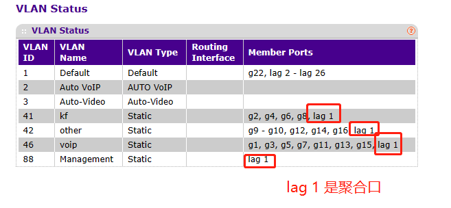

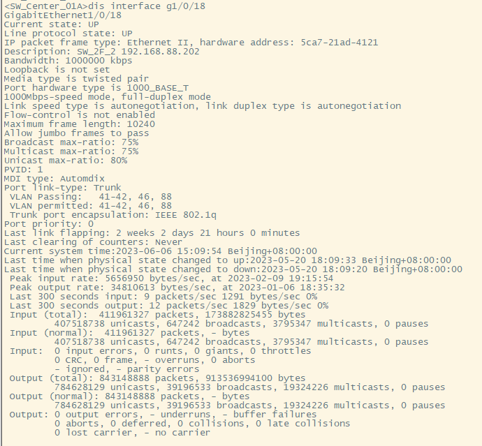

这个是线路连接的问题,
disp int GE1/0/18  看一下接口状态

谢谢你提供的新思路,简单看了下,时候没用错误包出现 <SW_Center_01A>dis interface g1/0/18 GigabitEthernet1/0/18 Current state: UP Line protocol state: UP IP packet frame type: Ethernet II, hardware address: 5ca7-21ad-4121 Description: SW_2F_2 192.168.88.202 Bandwidth: 1000000 kbps Loopback is not set Media type is twisted pair Port hardware type is 1000_BASE_T 1000Mbps-speed mode, full-duplex mode Link speed type is autonegotiation, link duplex type is autonegotiation Flow-control is not enabled Maximum frame length: 10240 Allow jumbo frames to pass Broadcast max-ratio: 75% Multicast max-ratio: 75% Unicast max-ratio: 80% PVID: 1 MDI type: Automdix Port link-type: Trunk VLAN Passing: 41-42, 46, 88 VLAN permitted: 41-42, 46, 88 Trunk port encapsulation: IEEE 802.1q Port priority: 0 Last link flapping: 2 weeks 2 days 21 hours 0 minutes Last clearing of counters: Never Current system time:2023-06-06 15:09:54 Beijing+08:00:00 Last time when physical state changed to up:2023-05-20 18:09:33 Beijing+08:00:00 Last time when physical state changed to down:2023-05-20 18:09:20 Beijing+08:00:00 Peak input rate: 5656950 bytes/sec, at 2023-02-09 19:15:54 Peak output rate: 34810613 bytes/sec, at 2023-01-06 18:35:32 Last 300 seconds input: 9 packets/sec 1291 bytes/sec 0% Last 300 seconds output: 12 packets/sec 1829 bytes/sec 0% Input (total): 411961327 packets, 173882825455 bytes 407518738 unicasts, 647242 broadcasts, 3795347 multicasts, 0 pauses Input (normal): 411961327 packets, - bytes 407518738 unicasts, 647242 broadcasts, 3795347 multicasts, 0 pauses Input: 0 input errors, 0 runts, 0 giants, 0 throttles 0 CRC, 0 frame, - overruns, 0 aborts - ignored, - parity errors Output (total): 843148888 packets, 913536994100 bytes 784628129 unicasts, 39196533 broadcasts, 19324226 multicasts, 0 pauses Output (normal): 843148888 packets, - bytes 784628129 unicasts, 39196533 broadcasts, 19324226 multicasts, 0 pauses Output: 0 output errors, - underruns, - buffer failures 0 aborts, 0 deferred, 0 collisions, 0 late collisions 0 lost carrier, - no carrier

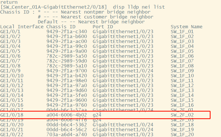

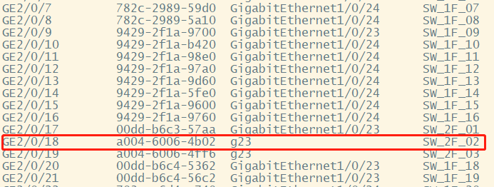

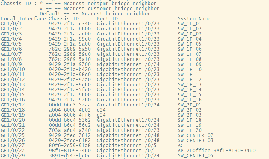

查看一下disp lldp nei list ,对端接口的配置和状态也看一下

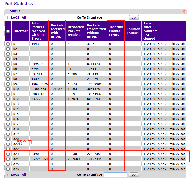

一起吹过的风 发表时间:2023-06-06
内容比较多,发到3楼了,对端也没有错

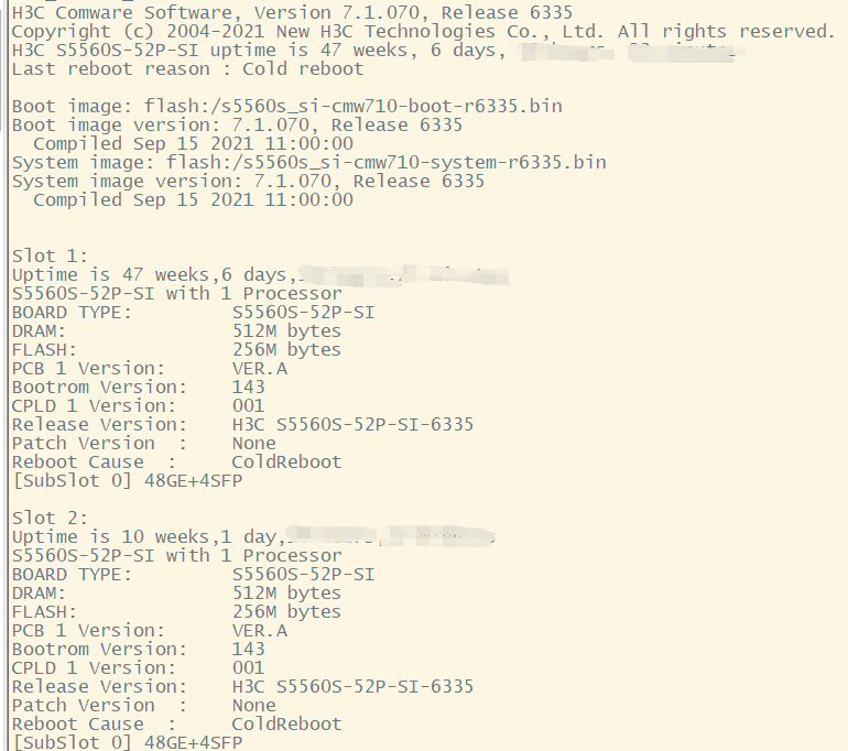

zhiliao_yXTd3M 发表时间:2023-06-06
看下所有交换机的运行时间,dis version,看看有没有断电导致重启的
叫我靓仔 发表时间:2023-06-06
都是正常的
