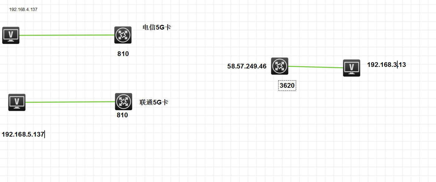

l2tp over ipsec 5G无线组网,同时只有一个分支l2tp隧道能正常建立
2023-06-13提问
  • 0收藏,1928浏览
如示意图,l2tp over ipsec 组网。2个 msr810 是分部,插得运营商的流量卡,做l2tp客户端,msr3620是总部路由器,接的电信专线的公网地址,用dis ike sa命令查看ipsec通道两个分部和总部建立正常,但是同时只有一个客户端能和总部建立成功l2tp隧道,只有其中一个分部的时正常,只要两个分部个同时接入,其中一个就必定l2tp隧道不能建立。
分部的debugging信息

 TunnelID=4332: Resent the packet for 2 times.
*Jun 13 12:52:15:274 2023 H3C L2TPV2/7/EVENT:
 TunnelID=13560: Resent the packet for 1 times.
*Jun 13 12:52:17:274 2023 H3C L2TPV2/7/EVENT:
 TunnelID=13560: Resent the packet for 2 times.
*Jun 13 12:52:19:274 2023 H3C L2TPV2/7/EVENT:
 TunnelID=63873: Delay-Cleanup timer expired and deleted the local tunnel.
*Jun 13 12:52:20:274 2023 H3C L2TPV2/7/EVENT:
 TunnelID=58572: Delay-Cleanup timer expired and deleted the local tunnel.
*Jun 13 12:52:21:240 2023 H3C L2TPV2/7/EVENT:
 Parsed Message-Type AVP: 1.
 Parsed Protocol-Version AVP. Version=1, Revision=0.
 Parsed Host-Name AVP: LAC.
 Parsed Vendor-Name AVP: H3C MSR810.
 Parsed Framing-Capabilities AVP: 3.
 Parsed Assigned-Tunnel-ID AVP: 60977.
 Parsed Bearer-Capabilities AVP: 3.
 Parsed Receive-Window-Size AVP: 1024.
 Parsed Challenge AVP: b4 03 c2 43 75 7e e7 2f 9d d9 7a 24 28 0d 56 88
 TunnelID=14337: Processed SCCRQ packet in Idle state, sent SCCRP packet and changed the tunnel state to Wait-connect.

zhiliao_tmyWEU 知了小白
分部的配置
version 7.1.064, Release 6728P19
sysname zaozhuang
password-recovery enable
vlan 1
vlan 100
controller Cellular0/0
controller Cellular1/0
eth-channel 0
controller Cellular1/1
eth-channel 0
interface Virtual-PPP1
ppp chap password cipher $c$3$7D0286vceDqcYCWTEFj0RI2z5UicplFQrZjCja57
ppp chap user gdgcc
ip address ppp-negotiate
l2tp-auto-client l2tp-group 1
interface NULL0
interface Vlan-interface100
ip address 192.168.4.202 255.255.255.0
interface GigabitEthernet0/0
port link-mode route
interface GigabitEthernet0/1
ip address 192.168.254.3 255.255.255.0
interface GigabitEthernet0/5
interface GigabitEthernet0/2
port link-mode bridge
port access vlan 100
interface GigabitEthernet0/3
interface GigabitEthernet0/4
interface Eth-channel1/0:0
tcp mss 1280
interface Eth-channel1/1:0
dialer circular enable
dialer-group 1
dialer timer idle 0
dialer timer wait-carrier 30
dialer timer autodial 5
dialer number #777 autodial
ip address cellular-alloc
tcp mss 1280
ipsec apply policy 1
scheduler logfile size 16
line class console
user-role network-admin
line class tty
user-role network-operator
line class vty
line con 0
line vty 0 63
ip route-static 0.0.0.0 0 Eth-channel1/1:0
ip route-static 192.168.3.13 32 Virtual-PPP1
performance-management
acl advanced 3300
rule 5 permit ip destination 58.57.249.46 0
domain system
domain default enable system
role name level-0
description Predefined level-0 role
role name level-1
description Predefined level-1 role
role name level-2
description Predefined level-2 role
role name level-3
description Predefined level-3 role
role name level-4
description Predefined level-4 role
role name level-5
description Predefined level-5 role
role name level-6
description Predefined level-6 role
role name level-7
description Predefined level-7 role
role name level-8
description Predefined level-8 role
role name level-9
description Predefined level-9 role
role name level-10
description Predefined level-10 role
role name level-11
description Predefined level-11 role
role name level-12
description Predefined level-12 role
role name level-13
description Predefined level-13 role
role name level-14
description Predefined level-14 role
user-group system
security-enhanced level 1
ipsec transform-set 1
esp encryption-algorithm 3des-cbc
esp authentication-algorithm md5
ipsec policy 1 1 isakmp
transform-set 1
security acl 3300
remote-address 58.57.249.46
ike-profile 1
l2tp-group 1 mode lac
lns-ip 58.57.249.46
tunnel name zaozhuang
tunnel password cipher $c$3$CjL3c5iqm/rWNN4KNCE1pmbPkWKv1sYiVIiQk+Z/
l2tp enable
ike profile 1
keychain 1
exchange-mode aggressive
match remote identity address 58.57.249.46 255.255.255.255
ike keychain 1
pre-shared-key address 58.57.249.46 255.255.255.255 key cipher $c$3$rBUE1H3Eu336B/MPB20QbkPv/+rqLTOTzlYjztRU
return
总部的配置:
version 7.1.064, Release 6728P25
sysname H3C
clock timezone Beijing add 08:00:00
clock protocol none
wlan global-configuration
telnet server enable
telnet server port 11013
undo resource-monitor output syslog snmp-notification netconf-event
security-zone intra-zone default permit
track 1 nqa entry admin test reaction 1
ip pool l2tp1 192.168.10.2 192.168.10.254
ip pool l2tp1 gateway 192.168.10.1
ip load-sharing mode per-flow src-ip global
dhcp enable
dhcp server always-broadcast
dns proxy enable
mirroring-group 1 local
system-working-mode standard
vlan 1
vlan 2
vlan 100
type icmp-echo
destination ip 192.168.254.2
frequency 100
next-hop ip 192.168.254.2
reaction 1 checked-element probe-fail threshold-type consecutive 5 action-type trigger-only
nqa schedule admin test start-time now lifetime forever
eth-channel 0
interface Dialer1
mtu 1492
interface Virtual-Template1
ppp authentication-mode chap domain system
remote address pool l2tp1
ip address 192.168.10.1 255.255.255.0
interface NULL0
interface LoopBack0
interface LoopBack100
ip address 2.1.1.1 255.255.255.255
interface Vlan-interface2
ip address 192.168.3.200 255.255.255.0
description LAN-interface
tcp mss 1280
description Single_Line1
ip address 58.57.249.46 255.255.255.252
dns server 219.146.1.66
tcp mss 1280
mirroring-group 1 mirroring-port both
tcp mss 1280
ip address 192.168.254.1 255.255.255.0
ipsec apply policy youxian
interface GigabitEthernet0/6
proxy-arp enable
mirroring-group 1 monitor-port
interface GigabitEthernet0/7
interface GigabitEthernet0/8
interface GigabitEthernet0/9
interface GigabitEthernet0/10
interface GigabitEthernet0/11
interface GigabitEthernet0/12
interface GigabitEthernet0/13
interface GigabitEthernet0/14
interface GigabitEthernet0/15
interface Ten-GigabitEthernet0/16
interface Ten-GigabitEthernet0/17
interface Ten-GigabitEthernet0/18
interface Ten-GigabitEthernet0/19
interface Ten-GigabitEthernet0/20
interface Ten-GigabitEthernet0/21
interface VE-L2VPN1
interface Eth-channel0/0:0
line class console
line class tty
line class vty
line con 0
line vty 0 63
authentication-mode scheme
protocol inbound telnet
ip route-static 0.0.0.0 0 GigabitEthernet0/1 58.57.249.45
ip route-static 115.0.0.0 8 58.57.249.45
ip route-static 117.0.0.0 8 58.57.249.45
ip route-static 140.249.148.132 32 58.57.249.45
ip route-static 192.168.4.137 32 192.168.254.2 track 1
ip route-static 192.168.4.137 32 192.168.10.2 preference 70
ip route-static 192.168.100.0 24 192.168.10.0
ip route-static 192.168.100.0 24 192.168.10.2
ip route-static 219.0.0.0 8 58.57.249.45
ip route-static 220.0.0.0 8 58.57.249.45
info-center loghost 127.0.0.1 port 3301
info-center source CFGLOG loghost level informational
ssh server enable
ssh server port 11011
acl advanced 3000
acl advanced 3001
rule 0 permit ip source 192.168.3.13 0 destination 192.168.4.0 0.0.0.255
acl advanced 3100
rule 1 deny ip source 2.1.1.1 0 destination 1.1.1.1 0
rule 2 deny ip source 192.168.3.200 0 destination 192.168.3.0 0.0.0.255
rule 3 deny ip source 192.168.3.13 0 destination 192.168.4.0 0.0.0.255
rule 10 permit ip
acl advanced 3300
rule 0 permit ip source 2.1.1.1 0 destination 1.1.1.1 0
rule 1 permit ip source 192.168.3.13 0 destination 192.168.4.137 0
undo password-control aging enable
undo password-control history enable
password-control length 6
password-control login-attempt 3 exceed lock-time 10
password-control update-interval 0
password-control login idle-time 0
radius scheme 1
domain system
authorization-attribute ip-pool l2tp1
authentication ppp local
authorization ppp local
role name level-0
role name level-1
role name level-2
role name level-3
role name level-4
role name level-5
role name level-6
role name level-7
role name level-8
role name level-9
role name level-10
role name level-11
role name level-12
role name level-13
role name level-14
user-group system
local-user admin class manage
password hash $h$6$7mFT4CUzxu5KRihu$NbBd/JcOZ3OoyT5+rLHNwAvZzA2pAhy1u8v2DHnksFO99h0oYwTylOP8mXtdFQJ1gB2iYvxAFDjIwZBV/VpNaA==
service-type ftp
service-type ssh telnet http https
authorization-attribute user-role network-admin
local-user admin1 class network
password cipher $c$3$TEAQCle27KSRpPNq8MMBGfIzBLl/W1eL4h6+IzI=
service-type ppp
authorization-attribute user-role network-operator
authorization-attribute ip 192.168.10.2
local-user gdgcc class network
password cipher $c$3$LutOAX7TzbCFRzira94CfCF76dXsK1oavzBWhnJV
service-type ppp
security-enhanced level 2
ipsec transform-set youxian
ipsec policy-template 1 1
transform-set 1
ike-profile 1
ipsec policy-template youxian 1
ike-profile 1
ipsec policy 1 1 isakmp template 1
ipsec policy policy1 10 isakmp template temp1
ipsec policy youxian 1 isakmp template youxian
l2tp-group 1 mode lns
allow l2tp virtual-template 1
tunnel name LNS
tunnel password cipher $c$3$xwS5mHywRk6Qo2gU0/8p5L5mBCJz+l5ce64nFcLM
l2tp enable
ike profile 1
keychain 1
match remote identity address 0.0.0.0 0.0.0.0
ike keychain 1
pre-shared-key address 0.0.0.0 0.0.0.0 key cipher $c$3$Tg+OTcPJl29i1DDo/pgPltyPT7T4BkBlPDFSU828
ip http port 6666
ip https port 11111
ip http enable
ip https enable
web new-style
url-filter category custom severity 65535
wlan ap-group default-group
vlan 1
return
zhiliao_tmyWEU 知了小白
现在在总部和两个分部的出接口上去掉ipsec policy apply ,只保留l2tp,两个分部和总部就能同时建立l2隧道了,各位老师能帮忙看看ipsec是哪里配置错了吗,困扰好几天了,以前厂家给配置的时候只有一个分部,那时候运行正常,现在我们自己想加个分部,就出现这个问题了。
