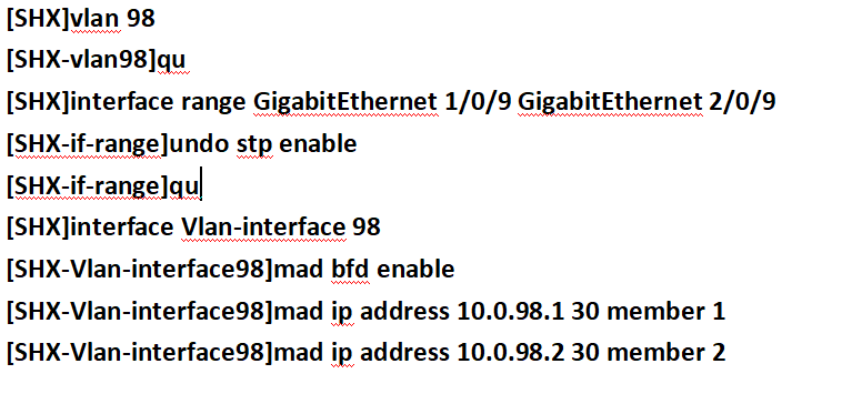

回复慕&:
正常情况下没问题啊 有配置不 完整的贴出来看下
zhang同学 发表时间:2023-06-22
[SHX]vlan 98 [SHX-vlan98]qu [SHX]interface range GigabitEthernet 1/0/9 GigabitEthernet 2/0/9 [SHX-if-range]undo stp enable [SHX-if-range]qu [SHX]interface Vlan-interface 98 [SHX-Vlan-interface98]mad bfd enable [SHX-Vlan-interface98]mad ip address 10.0.98.1 30 member 1 [SHX-Vlan-interface98]mad ip address 10.0.98.2 30 member 2

回复慕&:
看配置也没问题 你是用真机还是模拟器测的?模拟器bfd有问题 如果真机测的建议400问下具体情况 有点异常
