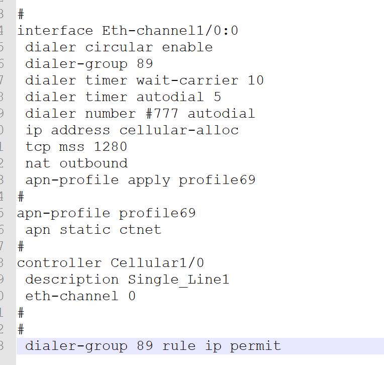

MSR1004 5G物联网卡提示如下,设备配置如图
2023-06-27提问
  • 0收藏,2025浏览
[H3C-Cellular1/0]
 [H3C-Cellular1/0]%Jan 1 01:17:30:324 2011 H3C CELLULAR/5/CELLULAR: Controller Cellular1/0: Service status changed from Limited to No Service.
 [H3C-Cellular1/0]%Jan 1 01:17:40:324 2011 H3C CELLULAR/5/CELLULAR: Controller Cellular1/0: Service status changed from No Service to Service Available.
 %Jan 1 01:17:40:324 2011 H3C CELLULAR/5/CELLULAR: Controller Cellular1/0: The network connection switched to NR.
 %Jan 1 01:17:41:903 2011 H3C CELLULAR/5/CELLULAR: Controller Cellular1/0: IPv4 dialing failed. Reason: Data call failed
 %Jan 1 01:17:56:812 2011 H3C CELLULAR/5/CELLULAR: Controller Cellular1/0: IPv4 dialing failed. Reason: Data call failed
试一下拨号接口删掉试一下,undo Cellular
或参考:https://zhiliao.h3c.com/Theme/details/202402
粉丝:4人 关注:1人
信号不好,把设备换个位置,
已解决!配置按照操作手册操作即可,此物联网卡为客户定制,原本就绑定了IP地址,和传统的建L2tp隧道的有所区别;拨号成功就可获取地址;
