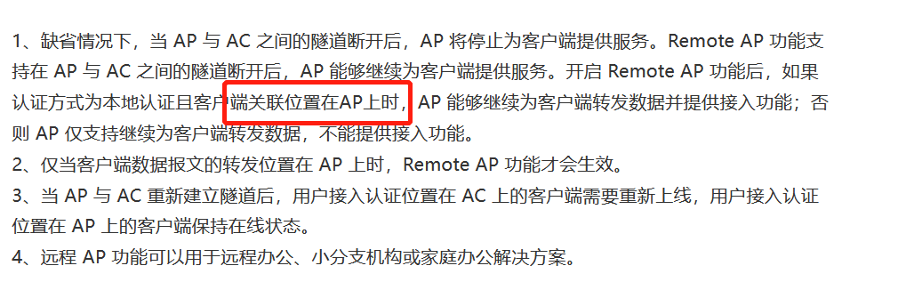

remote ap 要配置关联点和认证点在AP
