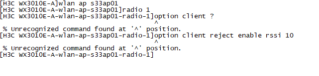

[AC] wlan ap ap1 model WA4320i-ACN
[AC-wlan-ap-ap1] radio 1
[AC-wlan-ap-ap1-radio-1] option client reject enable rssi 10
zhiliao_WF4AhW 知了小白
没有这个命令,是不是版本底的原因?
