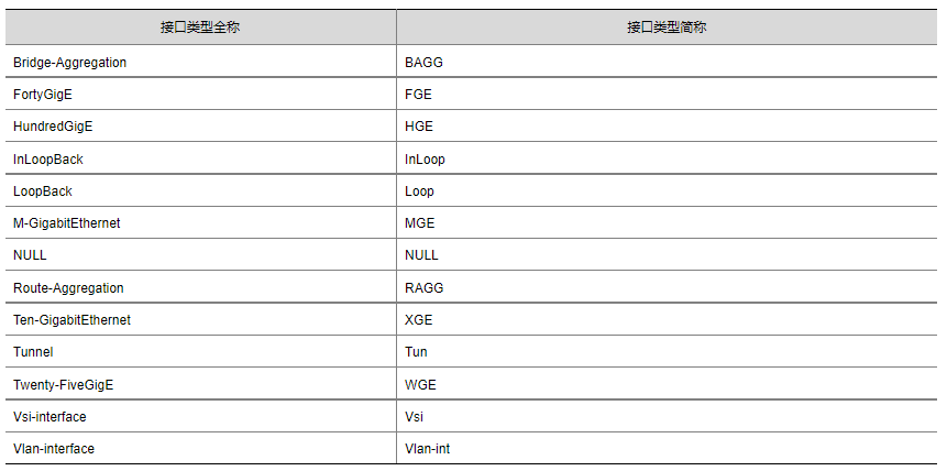

dis int brief看下,2.5G是smartrate-Ethernet,25的是WGE,5G的没见过,下面是常见的:

WGE是25G不是2.5G
