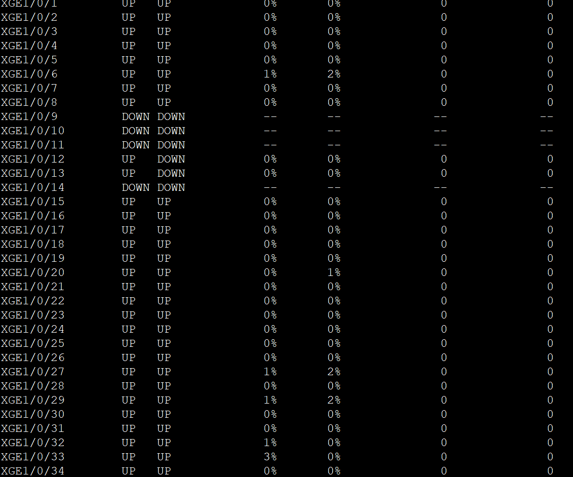

%Jul 26 02:23:13:131 2023 AHJK-5-16-37U-S6805-CCYW-1 RESMON/4/RESMON_MINOR: -Resource=output_flowrate_28-Total=10000-Used=8597-Free=1403; Free resource decreased to or below minor threshold 20%. %Jul 26 02:23:43:140 2023 AHJK-5-16-37U-S6805-CCYW-1 RESMON/3/RESMON_SEVERE: -Resource=output_flowrate_28-Total=10000-Used=9434-Free=566; Free resource decreased to or below severe threshold 10%. %Jul 26 02:27:13:203 2023 AHJK-5-16-37U-S6805-CCYW-1 RESMON/5/RESMON_SEVERE_RECOVERY: -Resource=output_flowrate_28-Total=10000-Used=8565-Free=1435; Free resource increased above severe threshold 10%. %Jul 26 02:27:43:212 2023 AHJK-5-16-37U-S6805-CCYW-1 RESMON/5/RESMON_MINOR_RECOVERY: -Resource=output_flowrate_28-Total=10000-Used=7679-Free=2321; Free resource increased above minor threshold 20%. %Jul 26 03:04:43:907 2023 AHJK-5-16-37U-S6805-CCYW-1 RESMON/4/RESMON_MINOR: -Resource=output_flowrate_28-Total=10000-Used=8085-Free=1915; Free resource decreased to or below minor threshold 20%. %Jul 26 03:05:43:925 2023 AHJK-5-16-37U-S6805-CCYW-1 RESMON/3/RESMON_SEVERE: -Resource=output_flowrate_28-Total=10000-Used=9345-Free=655; Free resource decreased to or below severe threshold 10%. %Jul 26 03:41:44:612 2023 AHJK-5-16-37U-S6805-CCYW-1 RESMON/5/RESMON_SEVERE_RECOVERY: -Resource=output_flowrate_28-Total=10000-Used=8903-Free=1097; Free resource increased above severe threshold 10%. %Jul 26 03:42:44:633 2023 AHJK-5-16-37U-S6805-CCYW-1 RESMON/5/RESMON_MINOR_RECOVERY: -Resource=output_flowrate_28-Total=10000-Used=7123-Free=2877; Free resource increased above minor threshold 20%. %Jul 26 03:49:44:764 2023 AHJK-5-16-37U-S6805-CCYW-1 RESMON/4/RESMON_MINOR: -Resource=output_flowrate_28-Total=10000-Used=8389-Free=1611; Free resource decreased to or below minor threshold 20%. %Jul 26 03:50:14:773 2023 AHJK-5-16-37U-S6805-CCYW-1 RESMON/3/RESMON_SEVERE: -Resource=output_flowrate_28-Total=10000-Used=9241-Free=759; Free resource decreased to or below severe threshold 10%. %Jul 26 03:56:14:892 2023 AHJK-5-16-37U-S6805-CCYW-1 RESMON/5/RESMON_SEVERE_RECOVERY: -Resource=output_flowrate_28-Total=10000-Used=8322-Free=1678; Free resource increased above severe threshold 10%. %Jul 26 03:56:44:901 2023 AHJK-5-16-37U-S6805-CCYW-1 RESMON/5/RESMON_MINOR_RECOVERY: -Resource=output_flowrate_28-Total=10000-Used=7353-Free=2647; Free resource increased above minor threshold 20%. %Jul 26 04:06:15:086 2023 AHJK-5-16-37U-S6805-CCYW-1 RESMON/4/RESMON_MINOR: -Resource=output_flowrate_28-Total=10000-Used=8081-Free=1919; Free resource decreased to or below minor threshold 20%. %Jul 26 04:07:15:096 2023 AHJK-5-16-37U-S6805-CCYW-1 RESMON/3/RESMON_SEVERE: -Resource=output_flowrate_28-Total=10000-Used=9555-Free=445; Free resource decreased to or below severe threshold 10%. %Jul 26 04:44:15:788 2023 AHJK-5-16-37U-S6805-CCYW-1 RESMON/5/RESMON_SEVERE_RECOVERY: -Resource=output_flowrate_28-Total=10000-Used=8696-Free=1304; Free resource increased above severe threshold 10%. %Jul 26 04:44:45:796 2023 AHJK-5-16-37U-S6805-CCYW-1 RESMON/5/RESMON_MINOR_RECOVERY: -Resource=output_flowrate_28-Total=10000-Used=7781-Free=2219; Free resource increased above minor threshold 20%.
交换机日志显示以上信息, 接口目前使用情况如图,请问这些告警信息是否有影响

出方向报文速率太高了,端口索引28
具体查看方法,可以参考案例
https://zhiliao.h3c.com/Theme/details/218517
粉丝:105人 关注:1人
您好,为了减少下一跳资源的占用,调整设备nd老化时间为20min,和arp表项一致,减少nd表项的同时占用
  ipv6 neighbor stale-aging second 1200
同时可以配置arp uni mode,该模式下arp表项不占用下一跳资源,进一步节省下一跳资源
