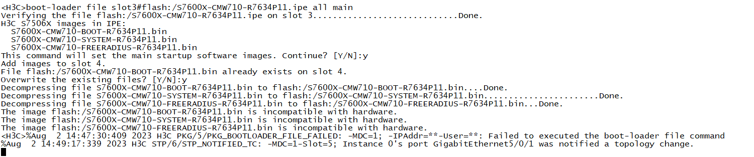

该交换机从r7596p10版本升级到R7634P11版本升级,报这个错:
<H3C>boot-loader file slot3#flash:/S7600X-CMW710-R7634P11.ipe all main
 Verifying the file flash:/S7600X-CMW710-R7634P11.ipe on slot 3.............................Done.
 H3C S7506X images in IPE: S7600X-CMW710-BOOT-R7634P11.bin
 S7600X-CMW710-SYSTEM-R7634P11.bin
 S7600X-CMW710-FREERADIUS-R7634P11.bin
This command will set the main startup software images. Continue? [Y/N]:y
Add images to slot 4. File flash:/S7600X-CMW710-BOOT-R7634P11.bin already exists on slot 4.
Overwrite the existing files? [Y/N]:y
Decompressing file S7600X-CMW710-BOOT-R7634P11.bin to flash:/S7600X-CMW710-BOOT-R7634P11.bin....Done.
Decompressing file S7600X-CMW710-SYSTEM-R7634P11.bin to flash:/S7600X-CMW710-SYSTEM-R7634P11.bin.......................Done.
Decompressing file S7600X-CMW710-FREERADIUS-R7634P11.bin to flash:/S7600X-CMW710-FREERADIUS-R7634P11.bin...Done.
The image flash:/S7600X-CMW710-BOOT-R7634P11.bin is incompatible with hardware.
The image flash:/S7600X-CMW710-SYSTEM-R7634P11.bin is incompatible with hardware.
The image flash:/S7600X-CMW710-FREERADIUS-R7634P11.bin is incompatible with hardware.
<H3C>%Aug 2 14:47:30:409 2023 H3C PKG/5/PKG_BOOTLOADER_FILE_FAILED: -MDC=1; -IPAddr=**-User=**: Failed to executed the boot-loader file command
请问下这会是什么原因呢?

和硬件不兼容。
软件包下载的不对,重新下载对应的软件包,看一下该设备是否配套
您好,建议查看对应的版本说明书,查看其版本配套表和本版本支持的软,硬件特性列表,看下是否适配。
