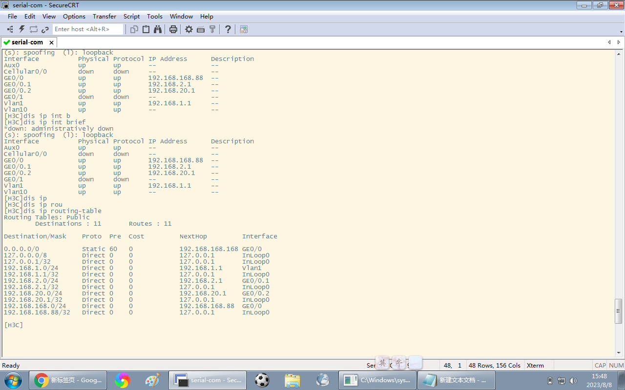

检查下路由器接口不要有多余配置
[r1]interface GigabitEthernet 0/0.1
[r1-GigabitEthernet0/0.1]vlan-type dot1g vid 10
[r1-GigabitEthernet0/0.1Jip add 192.168.10.1 24
[r1-GigabitEthernet0/0.1]qu
[r1interface GigabitEthernet 0/0.2
[r1-GigabitEthernet0/0.2]vlan-type dot1q vid 20
[r1-GigabitEthernet0/0.2lip address 192.168.20.1 24
[r1-GigabitEthernet0/0.2]qu
[r1]interface GigabitEthernet 0/0.3
[r1-GigabitEthernet0/0.3]vlan-type dot1q vid 30
[r1-GigabitEthernet0/0.3]ip address 192.168.30.1 24
[r1-GigabitEthernet0/0.3]qu

你是哪里不通,终端和网关吗?还是终端和外网不通;
你的路由和交换机的互联接口时哪些:
路由的g0/0 和交换机的g1/0/47 ?
路由的g0/0可以获取IP,电脑接0/5可以上网1.1段,路由的g0/9 接交换机的g1/0/47 现在的问题是电脑接1/0/44上不了网,

交换机在VLAN10的接口上不了网
