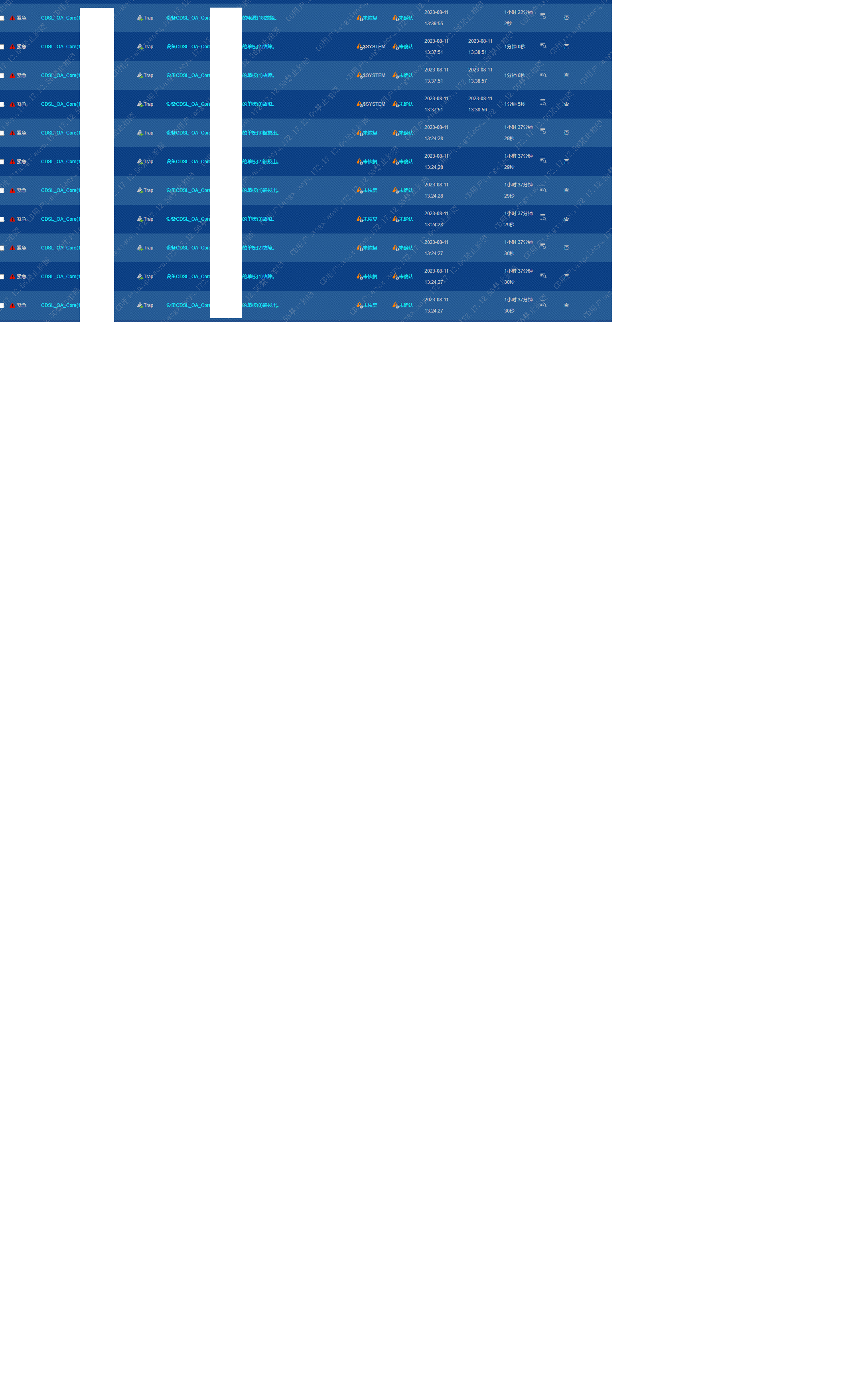

堆叠异常分裂,所有的业务口、逻辑口全部shutdown,后面手动重启交换机后正常,看日志是这个,是硬件出问题了吗?
8>Aug 11 13:24:18 2023 CDSL_OA_Core %%10DRVPLAT/4/DrvDebug: -Chassis=1-Slot=2; IPIPE has blocked and cannot be repaired. The device will restart on slot 4!
然后接着板卡提示故障
