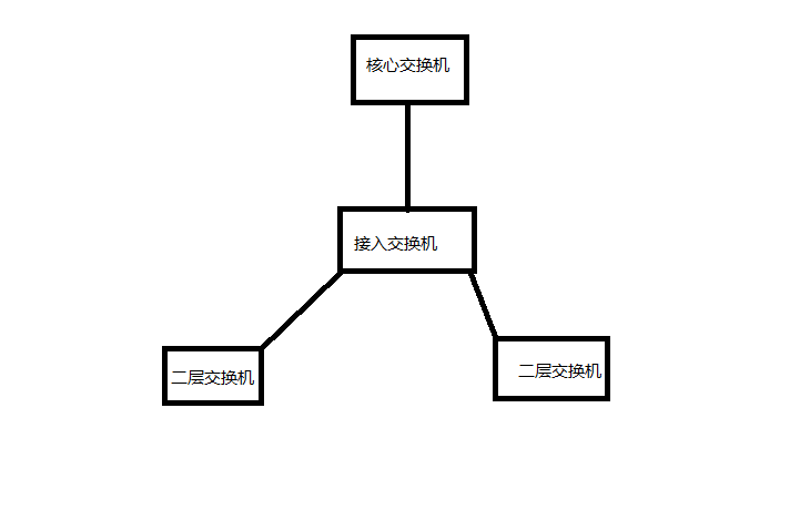

这样配置的acl  9段的访问4段的不通  这是什么原因呢
这样子组网方式

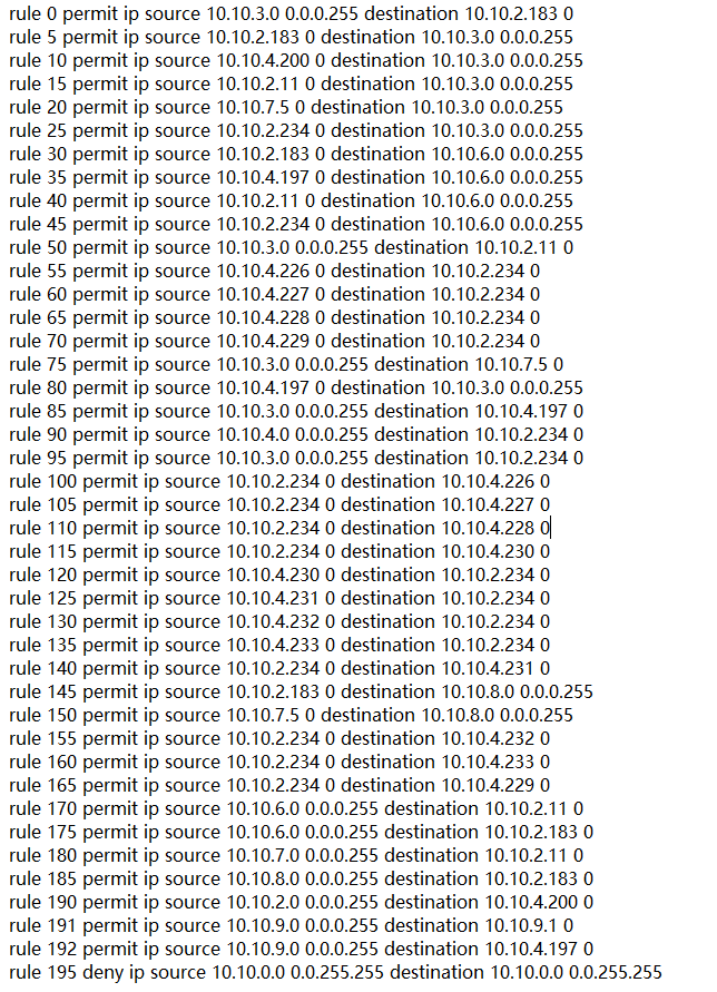

acl number 3000
rule 0 permit ip source 10.10.3.0 0.0.0.255 destination 10.10.2.183 0
rule 5 permit ip source 10.10.2.183 0 destination 10.10.3.0 0.0.0.255
rule 10 permit ip source 10.10.4.200 0 destination 10.10.3.0 0.0.0.255
rule 15 permit ip source 10.10.2.11 0 destination 10.10.3.0 0.0.0.255
rule 20 permit ip source 10.10.7.5 0 destination 10.10.3.0 0.0.0.255
rule 25 permit ip source 10.10.2.234 0 destination 10.10.3.0 0.0.0.255
rule 30 permit ip source 10.10.2.183 0 destination 10.10.6.0 0.0.0.255
rule 35 permit ip source 10.10.4.197 0 destination 10.10.6.0 0.0.0.255
rule 40 permit ip source 10.10.2.11 0 destination 10.10.6.0 0.0.0.255
rule 45 permit ip source 10.10.2.234 0 destination 10.10.6.0 0.0.0.255
rule 50 permit ip source 10.10.3.0 0.0.0.255 destination 10.10.2.11 0
rule 55 permit ip source 10.10.4.226 0 destination 10.10.2.234 0
rule 60 permit ip source 10.10.4.227 0 destination 10.10.2.234 0
rule 65 permit ip source 10.10.4.228 0 destination 10.10.2.234 0
rule 70 permit ip source 10.10.4.229 0 destination 10.10.2.234 0
rule 75 permit ip source 10.10.3.0 0.0.0.255 destination 10.10.7.5 0
rule 80 permit ip source 10.10.4.197 0 destination 10.10.3.0 0.0.0.255
rule 85 permit ip source 10.10.3.0 0.0.0.255 destination 10.10.4.197 0
rule 90 permit ip source 10.10.4.0 0.0.0.255 destination 10.10.2.234 0
rule 95 permit ip source 10.10.3.0 0.0.0.255 destination 10.10.2.234 0
rule 100 permit ip source 10.10.2.234 0 destination 10.10.4.226 0
rule 105 permit ip source 10.10.2.234 0 destination 10.10.4.227 0
rule 110 permit ip source 10.10.2.234 0 destination 10.10.4.228 0
rule 115 permit ip source 10.10.2.234 0 destination 10.10.4.230 0
rule 120 permit ip source 10.10.4.230 0 destination 10.10.2.234 0
rule 125 permit ip source 10.10.4.231 0 destination 10.10.2.234 0
rule 130 permit ip source 10.10.4.232 0 destination 10.10.2.234 0
rule 135 permit ip source 10.10.4.233 0 destination 10.10.2.234 0
rule 140 permit ip source 10.10.2.234 0 destination 10.10.4.231 0
rule 145 permit ip source 10.10.2.183 0 destination 10.10.8.0 0.0.0.255
rule 150 permit ip source 10.10.7.5 0 destination 10.10.8.0 0.0.0.255
rule 155 permit ip source 10.10.2.234 0 destination 10.10.4.232 0
rule 160 permit ip source 10.10.2.234 0 destination 10.10.4.233 0
rule 165 permit ip source 10.10.2.234 0 destination 10.10.4.229 0
rule 170 permit ip source 10.10.6.0 0.0.0.255 destination 10.10.2.11 0
rule 175 permit ip source 10.10.6.0 0.0.0.255 destination 10.10.2.183 0
rule 180 permit ip source 10.10.7.0 0.0.0.255 destination 10.10.2.11 0
rule 185 permit ip source 10.10.8.0 0.0.0.255 destination 10.10.2.183 0
rule 190 permit ip source 10.10.2.0 0.0.0.255 destination 10.10.4.200 0
rule 191 permit ip source 10.10.9.0 0.0.0.255 destination 10.10.9.1 0
rule 192 permit ip source 10.10.9.0 0.0.0.255 destination 10.10.4.197 0
rule 195 deny ip source 10.10.2.0 0.0.0.255 destination 10.10.0.0 0.0.255.255
rule 200 deny ip source 10.10.3.0 0.0.0.255 destination 10.10.0.0 0.0.255.255
rule 205 deny ip source 10.10.4.0 0.0.0.255 destination 10.10.0.0 0.0.255.255
rule 210 deny ip source 10.10.5.0 0.0.0.255 destination 10.10.0.0 0.0.255.255
rule 215 deny ip source 10.10.6.0 0.0.0.255 destination 10.10.0.0 0.0.255.255
rule 220 deny ip source 10.10.7.0 0.0.0.255 destination 10.10.0.0 0.0.255.255
rule 225 deny ip source 10.10.9.0 0.0.0.255 destination 10.10.0.0 0.0.255.255
这是全部配置
粉丝:3人 关注:10人
acl配置没问题,问题出现在接入层,有没有放通vlan
在deny前边加个你想访问的网段测试下
