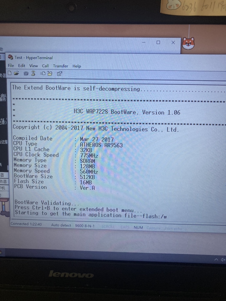

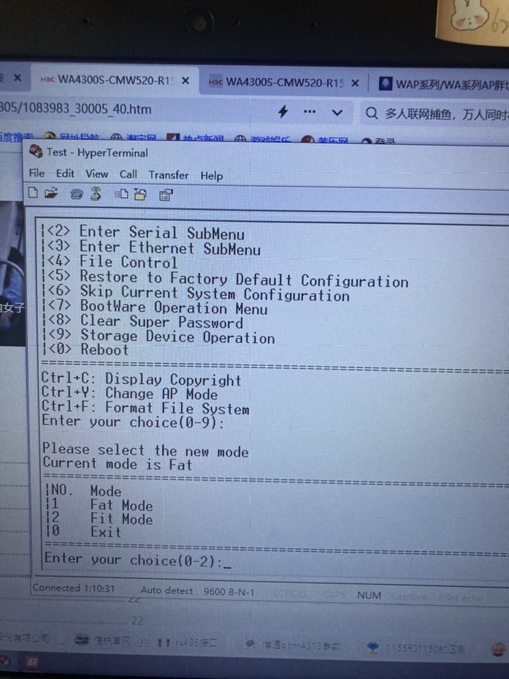

AP:型号:EWP-WAP722S-FIT,现在已经变成FAT模式,但是重启后就无法使用!总感觉那里设置还是不对!

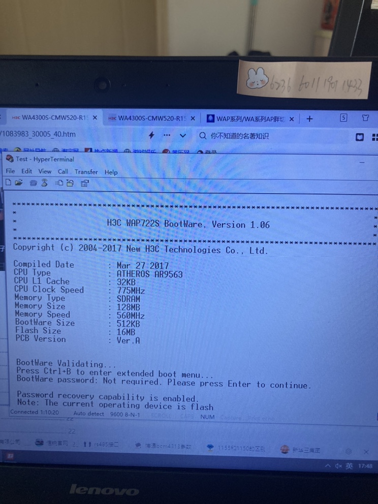

应该是选择4,设置一下,下次启动文件的程序
https://www.h3c.com/cn/d_201805/1083983_30005_40.htm#_Toc511724958
B.6 通过BootWare菜单进行文件管理
对文件类型的修改、显示等可以在文件控制子菜单下完成:
在BootWare主菜单下键入<4>,系统会进入文件控制子菜单。系统显示如下:
===============================<File CONTROL>===============================
|Note:the operating device is flash                                        |
|<1> Display All File(s)                                                   |
|<2> Set Application File type                                             |
|<3> Delete File                                                           |
|<0> Exit To Main Menu                                                     |
Enter your choice(0-3):
1. 显示所有文件
键入<1>进入该选项,系统提示:
Display all file(s) in flash:
 "M" = MAIN      "B" = BACKUP      "S" = SECURE      "N/A" = NOT ASSIGNED
|NO. Size(B)   Time                 Type   Name                            |
|1   10788864   July/16/2015 05:30:27 M      wa4300s_fat.bin                  |
|2   388        July/16/2015 05:16:58 N/A    private-data.txt                |
|3   1441       July/16/2015 05:17:30 N/A    startup.cfg                     |
|4   1326       July/16/2015 05:17:15 N/A    system.xml                      |
看上面的补充,设置1为main 文件后试试

System application is starting... User interface con0 is available. Press ENTER to get started. <WAP722S> #Jan 1 00:00:17:474 2009 WAP722S SHELL/4/LOGIN: Trap 1.3.6.1.4.1.25506.2.2.1.1.3.0.1<hh3cLogIn>: login from Console %Jan 1 00:00:17:474 2009 WAP722S SHELL/5/SHELL_LOGIN: Console logged in from co n0. <WAP722S> 只有在这个状态的时候,AP才可以正常使用,可是以重新启动就无法使用了!
