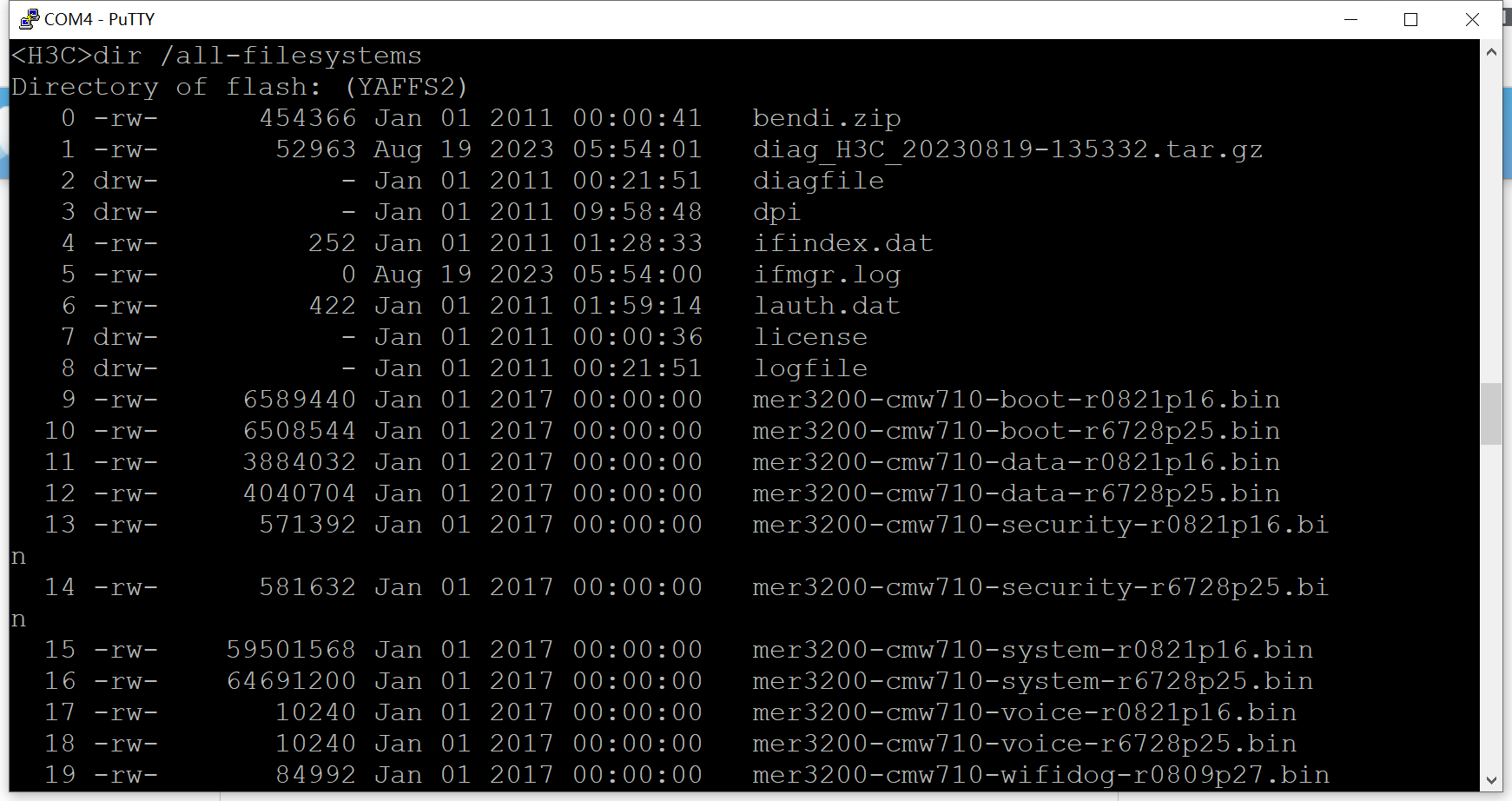

dir /all-filesystems看下
有没有没用的升级包 删除一下
有两个版本文件,0821和6728 看看现在使用的是哪个,没用的删除就可以

怎么查看已有的升级包呢
zhiliao_LxX7nl 发表时间:2023-09-04
上图帮你看下
zhiliao_sEUyB 发表时间:2023-09-04
比如这个,哪个能删除呢 dir /all-filesystems Directory of flash: (YAFFS2) 0 -rw- 454366 Jan 01 2011 00:00:41 bendi.zip 1 -rw- 52963 Aug 19 2023 05:54:01 diag_H3C_20230819-135332.tar.gz 2 drw- - Jan 01 2011 00:21:51 diagfile 3 drw- - Jan 01 2011 09:58:48 dpi 4 -rw- 252 Jan 01 2011 01:28:33 ifindex.dat 5 -rw- 0 Aug 19 2023 05:54:00 ifmgr.log 6 -rw- 422 Jan 01 2011 01:59:14 lauth.dat 7 drw- - Jan 01 2011 00:00:36 license 8 drw- - Jan 01 2011 00:21:51 logfile 9 -rw- 6589440 Jan 01 2017 00:00:00 mer3200-cmw710-boot-r0821p16.bin 10 -rw- 6508544 Jan 01 2017 00:00:00 mer3200-cmw710-boot-r6728p25.bin 11 -rw- 3884032 Jan 01 2017 00:00:00 mer3200-cmw710-data-r0821p16.bin 12 -rw- 4040704 Jan 01 2017 00:00:00 mer3200-cmw710-data-r6728p25.bin 13 -rw- 571392 Jan 01 2017 00:00:00 mer3200-cmw710-security-r0821p16.bi n 14 -rw- 581632 Jan 01 2017 00:00:00 mer3200-cmw710-security-r6728p25.bi n 15 -rw- 59501568 Jan 01 2017 00:00:00 mer3200-cmw710-system-r0821p16.bin 16 -rw- 64691200 Jan 01 2017 00:00:00 mer3200-cmw710-system-r6728p25.bin 17 -rw- 10240 Jan 01 2017 00:00:00 mer3200-cmw710-voice-r0821p16.bin 18 -rw- 10240 Jan 01 2017 00:00:00 mer3200-cmw710-voice-r6728p25.bin 19 -rw- 84992 Jan 01 2017 00:00:00 mer3200-cmw710-wifidog-r0809p27.bin 20 -rw- 84992 Jan 01 2017 00:00:00 mer3200-cmw710-wifidog-r0809p33.bin 21 -rw- 84992 Jan 01 2017 00:00:00 mer3200-cmw710-wifidog-r0821p16.bin 22 -rw- 83968 Jan 01 2017 00:00:00 mer3200-cmw710-wifidog-r6728p25.bin 23 -rw- 93184 Jan 01 2017 00:00:00 mer3200-cmw710-wwd-r0809p27.bin 24 -rw- 93184 Jan 01 2017 00:00:00 mer3200-cmw710-wwd-r0809p33.bin 25 -rw- 93184 Jan 01 2017 00:00:00 mer3200-cmw710-wwd-r0821p16.bin 26 -rw- 93184 Jan 01 2017 00:00:00 mer3200-cmw710-wwd-r6728p25.bin 27 -rw- 6589440 Jan 01 2017 00:00:00 mer32001cmw710-boot-r0821p16.bin 28 -rw- 3884032 Jan 01 2017 00:00:00 mer32001cmw710-data-r0821p16.bin 29 -rw- 571392 Jan 01 2017 00:00:00 mer32001cmw710-security-r0821p16.bi n 30 -rw- 59501568 Jan 01 2017 00:00:00 mer32001cmw710-system-r0821p16.bin 31 -rw- 10240 Jan 01 2017 00:00:00 mer32001cmw710-voice-r0821p16.bin 32 -rw- 84992 Jan 01 2017 00:00:00 mer32001cmw710-wifidog-r0821p16.bin 33 -rw- 93184 Jan 01 2017 00:00:00 mer32001cmw710-wwd-r0821p16.bin 34 drw- - Jan 01 2011 00:02:37 pki 35 drw- - Aug 19 2023 06:23:41 portalWeb_cn 36 drw- - Aug 19 2023 06:23:41 portalWeb_en 37 -rw- 0 Jan 01 2011 00:02:09 portal_pageinfo.txt 38 -rw- 0 Aug 19 2023 05:54:00 scm.log 39 drw- - Jan 01 2011 00:00:44 seclog 40 -rw- 7900 Jan 01 2011 01:28:33 startup.cfg 41 -rw- 172525 Jan 01 2011 01:28:34 startup.mdb 42 -rw- 0 Aug 19 2023 05:54:00 trace.log 43 -rw- 72830 Jan 01 2011 00:00:41 weixin.zip 251904 KB total (36212 KB free)

删除一些无关的文件
比如这个,哪个能删除呢
