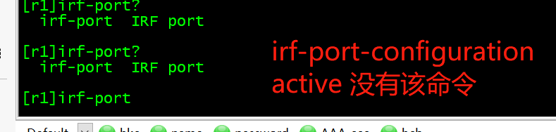

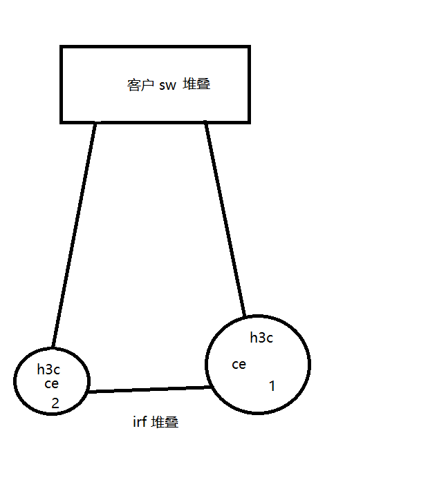

route1:
 irf priority 10
 irf-port 1
 port group interface GigabitEthernet0/0
没有发现有irf-port-configuration active命令
 route2:
 irf member 2
 irf priority 2
irf-port 2
