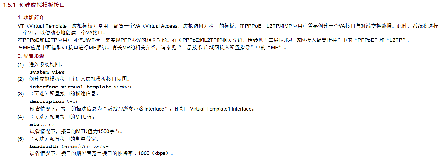

这是什么接口,有什么作用
Virtual-ACCESs_ changed to up. ed in from 10.10.102.1. {PAddr=10.10.102.1-User=admin; Command is dis logbuffer gged out from 10.10.102.1. dr=**-User=**; Command is undo debugging all ocol state on the interface Virtual-Access1 changed to down. tate on the interface Virtual-Access1 changed to down. state on the interface virtual-Access1 changed to up. -ocol state on the interface Virtual-Access1 changed to up. tool state on the interface Virtual-Access1 changed to down. tool state on the interface Virtual-Access1 changed to up. toco] state on the interface Virtual-Access1 changed to down. state on the interface Virtual-Access1 changed to down, state on the interface Virtual-Access1 changed to up. toco] state on the interface virtual-Access1 changed to up. tocol state on the interface Virtual-Access1 changed to down otocol state on the interface Virtual-Access1 changed to up. otocol state on the interface virtual-Access1 changed to down. state on the interface Virtual-Access1 changed to down. state on the interface Virtual-Access1 changed to up. otocol state on the interface Virtual-Access1 changed to up. otocol state on the interface Virtual-Access1 changed to down. •otocol state on the interface virtual-Access1 changed to up. rotocol state on the interface virtual-Access1 changed to down. 7 state on the interface Virtual-Access1 changed to down. 1 state on the interface Virtual-Access1 changed to up. rotocol state on the interface Virtual-Access1 changed to up. rotocol state on the interface virtual-Access1 changed to down. rotocol state on the interface Virtual-Access1 changed to up. logged in from 10.10.102.1. ty0-IPAddr=10.10.102.1-User=admin; Command is dis logbuffer -185.142 MÇüªE"

那个是根据你的VT接口配置生成的VA接口,具体信息看图。

虚拟接口,做SSLVPN接入,PPP等生成的接口

一般是VPN的虚接口
