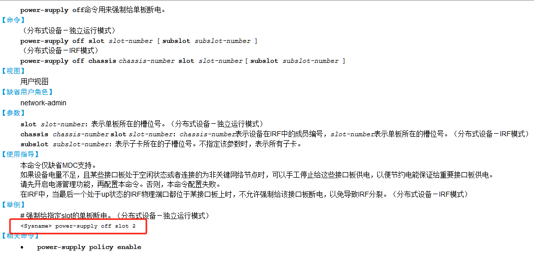

看是否只是 power-supply off命令用来强制给单板断电。
配置命令为hardware-failure-detection { board | chip | forwarding } { isolate | off | reset | warning },参数选择为isolate命令表示隔离。对交换网板配置为switch-fabric isolate slot slot-number [ channel channel-number ],具体限制及说明参考命令手册说明。
命令手册:https://www.h3c.com/cn/d_202309/1933949_30005_0.htm#_Toc145942545
