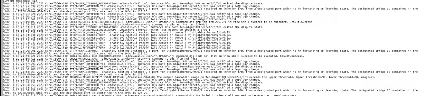

核心交换机弹这几个日志
2023-11-06提问
  • 0收藏,3852浏览
第一条:Instance 0's port Ten-GigabitEthernet2/0/0/1 received an inferior BPDU from a designated port which is in forwarding or learning state. The designated bridge ID contained in the BPDU is 32768.001e-cd58-7fa9, and the designated port ID contained in the BPDU is 128.20.
第二条:Instance 0's port Ten-GigabitEthernet2/0/0/1 was notified a topology change.
第三条:Instance 0's port Ten-GigabitEthernet2/0/0/1 exited the dispute state.
这一般是什么问题导致的?设备都有开STP
