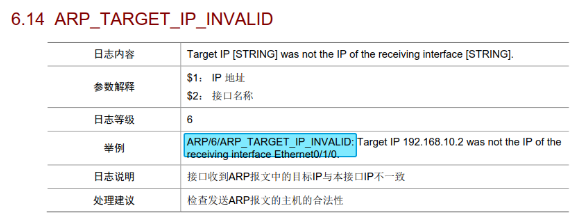

%Nov 17 10:43:20:726 2023 XWOAGH1 ARP/6/ARP_TARGET_IP_INVALID: Target IP 10.0.100.254 was not the IP of the receiving interface Vlan-interface100.
%Nov 17 10:34:54:274 2023 XWOAGH1 ARP/6/ARP_TARGET_IP_INVALID: Target IP 10.0.100.254 was not the IP of the receiving interface Vlan-interface100.
如上现象,VLAN100是设备管理网段,交换机频繁出现这种日志,一开始几分钟刷一次,但是显示的IP是一个网络里没有的IP,也查不到ARP和MAC信息,以为是MIC的PING报文这个功能导致的,把MIC关掉后每隔10分钟左右还是会刷一次,但是IP变成了设备管理的网关IP,这个IP是在核心交换机上,而且只有部分接入交换机上会刷这个日志,有人遇到过吗?
