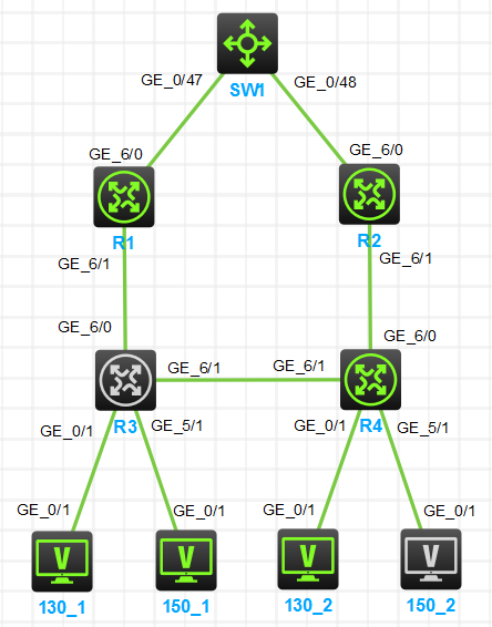

现象:
从SW1上ping130.131.12.254和150.131.12.254,当把R3关机时,R4成为master
1、此时如果R4上接了pc且为开机状态,那么130.131.12.254和150.131.12.254可以一直ping通
2、此时如果R4没有接pc或者pc是关机状态,过几秒vlanif10和vlanif20就会从up状态变为down状态,同时master会变为Initialize状态,然后130.131.12.254和150.131.12.254就一直ping不通
问题:
因为vlanif接口状态up变为down,使得master变为Initialize状态,导致网关不通,有办法让vlanif接口一直up的吗?
SW1:
interface Vlan-interface1
  ip address 1.1.1.1 255.255.255.0
interface GigabitEthernet1/0/47
  port link-mode route
  ip address 172.16.1.1 255.255.255.252
interface GigabitEthernet1/0/48
  ip address 172.16.1.5 255.255.255.252
ospf 1 router-id 1.1.1.1
  area 0.0.0.0
    network 1.1.1.0 0.0.0.255
    network 172.16.1.0 0.0.0.3
    network 172.16.1.4 0.0.0.3
R1:
interface LoopBack0
  ip address 1.1.2.1 255.255.255.255
interface GigabitEthernet6/0
  ip address 172.16.1.2 255.255.255.252
interface GigabitEthernet6/1
  ip address 145.131.12.1 255.255.255.252
ospf 1 router-id 1.1.2.1
  area 0.0.0.0
    network 145.131.12.0 0.0.0.3
R2:
interface LoopBack0
  ip address 1.1.2.2 255.255.255.255
  ip address 172.16.1.6 255.255.255.252
  ip address 146.131.12.1 255.255.255.252
ospf 1 router-id 1.1.2.2
  area 0.0.0.0
    network 146.131.12.0 0.0.0.3
R3:
interface Vlan-interface10
  ip address 130.131.12.252 255.255.255.0
  vrrp vrid 10 virtual-ip 130.131.12.254
  vrrp vrid 10 priority 120
interface Vlan-interface20
  ip address 150.131.12.252 255.255.255.0
  vrrp vrid 20 virtual-ip 150.131.12.254
  ip address 145.131.12.2 255.255.255.252
interface GigabitEthernet0/0
  port link-mode bridge
  port access vlan 10
interface GigabitEthernet0/1
  port access vlan 10
interface GigabitEthernet0/2
  port access vlan 10
interface GigabitEthernet5/0
  port access vlan 20
interface GigabitEthernet5/1
  port access vlan 20
  port link-type trunk
  port trunk permit vlan 1 10 20
ospf 1 router-id 145.131.12.2
  area 0.0.0.0
    network 130.131.12.0 0.0.0.255
    network 150.131.12.0 0.0.0.255
R4:
  ip address 130.131.12.253 255.255.255.0
  ip address 150.131.12.253 255.255.255.0
  vrrp vrid 20 priority 120
  ip address 146.131.12.2 255.255.255.252
  port access vlan 10
  port access vlan 10
  port access vlan 10
  port access vlan 20
  port access vlan 20
ospf 1 router-id 146.131.12.2
  area 0.0.0.0
WXT 一段
当二层口放通vlan,二层口up,vlan就能up,所以要想vlan up,你只需要找一个口让他自环up(loopback internal),放通这个vlan即可
