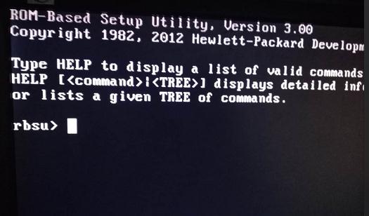

HP proliant ML10V2 无法进入bios
2023-12-11提问
  • 0收藏,1765浏览
按F9进了这个界面,怎么关闭这个?进入UI界面
粉丝:34人 关注:25人
进入了BIOS的命令行模式,使用以下方式切换回图形:
Follow the steps given below to change back to the Full-screen Menu-based mode:
  1. Type “SHOW CONFIG BIOS INTERFACE MODE” at the “rbsu” prompt.
    It gives two options Auto and command-line.
  2. Type “Set Config Bios Interface Mode 1” to select the first option.
  3. Type “Exit” at rbsu prompt.
  4. Reboot the server and Access RBSU by pressing F9.
    The interface would be changed from CLI mode to the Full-screen Menu-based mode
                rbsu> SHOW CONFIG BIOS INTERFACE MODE <ENTER>
                1:AUTO
                2:COMMAND-LINE <=
                rbsu> SET CONFIG BIOS INTERFACE MODE 1
                1:AUTO <=
                2:COMMAND-LINE
                rbsu>EXIT
