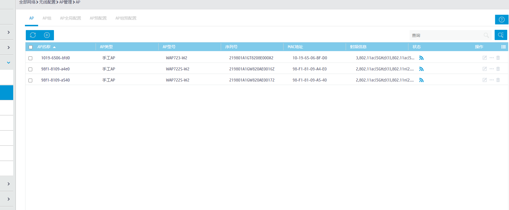

这个AC 下面有7个AP   但是只能显示3 个      我是恢复出厂设置后出现的这样问题  麻烦大神们帮忙看一下 ,感谢
<H3C>dis wlan ap al
Total number of APs: 3
Total number of connected APs: 3
Total number of connected manual APs: 3
Total number of connected auto APs: 0
Total number of connected common APs: 3
Total number of connected WTUs: 0
Total number of inside APs: 0
Maximum supported APs: 40
Remaining APs: 37
Total AP licenses: 10
Local AP licenses: 10
Server AP licenses: 0
Remaining Local AP licenses: 7
Sync AP licenses: 0
开启自动注册先试下
最直接的方式是看ac的日志和ap的日志
