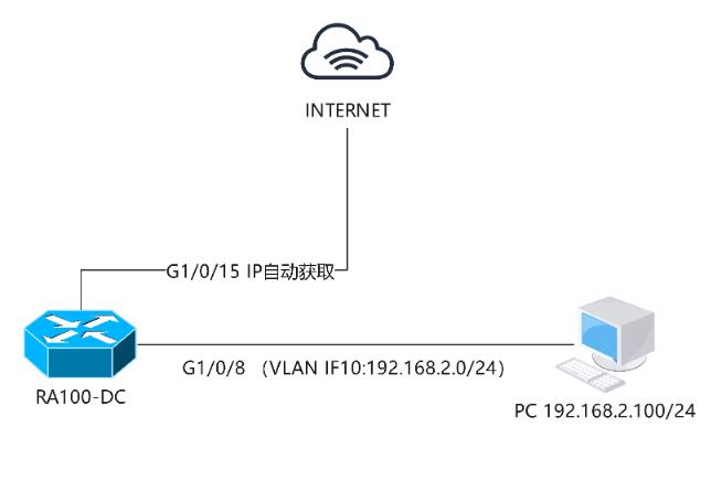

H3C RA100-DC设置了内外网,上不了网
2023-12-26提问
  • 0收藏,2229浏览
黄生 一段
粉丝:1人 关注:1人
G1/0/15为WAN口,自动获取IP
G1/0/8-G1/0/11为LAN口,PC接在1/0/8,自动获取到了IP地址192.168.2.100,PC ping不通192.168.1.1,路由器上可以ping通192.168.1.1,路由器也可以ping通192.168.2.100

RA100是电信IPRAN场景定制款型,大部分功能有裁剪,不支持如NAT、IPsec等功能,不建议昨晚出口网关设备
谢谢

1.1在哪?
电脑就一个网卡吧?
配置了策略路由也不行 [H3C]acl advanced 3101 [H3C-acl-ipv4-adv-3101]rule permit ip [H3C-acl-ipv4-adv-3101]quit [H3C]policy-based-route aaa permit node 5 [H3C-pbr-aaa-5]if-match acl 3101 [H3C-pbr-aaa-5]apply next-hop 192.168.1.1 [H3C]ip local policy-based-route aaa
黄生 发表时间:2023-12-26 更多>>
WAN口自动获取IP后,网关是192.168.1.1
黄生 发表时间:2023-12-26
电脑是普通的单网卡
黄生 发表时间:2023-12-26
15口配置一下nat outbound
zhiliao_sEUyB 发表时间:2023-12-26
没有这个功能。。。。 [H3C-GigabitEthernet1/0/15]? Gigabitethernet_l3 interface view commands: arp ARP module bandwidth Specify the expected bandwidth bfd BFD module cfd Connectivity Fault Detection (CFD) module dampening Set port dampening attributes ddns Dynamic Domain Name System (DDNS) module default Restore the default settings description Describe the interface dhcp DHCP module diagnostic-logfile Diagnostic log file configuration display Display current system information dldp DLDP module dns Domain Name System (DNS) module duplex Status of duplex enable Enable functions end Alias for 'return' esmc Ethernet Synchronous Message Channel exit Alias for 'quit' flow-control Enable flow control function igmp Internet Group Management Protocol (IGMP) module ip Specify IP configuration ipsec IP Security module ipv6 Specify IPv6 configuration isis Configure interface parameters for IS-IS jumboframe Specify jumbo frame forwarding lacp Configure LACP protocol link-aggregation Specify link aggregation group configuration information link-delay Set the physical state change suppression lldp Link Layer Discovery Protocol (802.1ab) local-proxy-arp Specify local proxy ARP function for same interface local-proxy-nd Local ND proxy function lock Lock the current line logfile Log file configuration loopback Specify loopback of current port mirroring-group Specify mirroring group mld Multicast Listener Discovery (MLD) module monitor System monitor mpls Multiprotocol Label Switching (MPLS) module mtu Specify Maximum Transmission Unit(MTU) of the interface multicast Multicast module no Alias for 'undo' ntp-service Network Time Protocol (NTP) module oam OAM module ospf OSPF module ospfv3 OSPFv3 interface commands packet-filter Packet filter settings pim Protocol Independent Multicast (PIM) module ping Ping function port Specify a port portal Portal authentication module proxy-arp Specify proxy ARP function proxy-nd ND proxy function ptp Precision Time Protocol module qos Quality of Service (QoS) module quit Exit from current command view repeat Repeat executing history commands reset Reset operation return Exit to User View rip Configure interface parameters for RIP ripng Configure interface parameters for RIPng rmon RMON module rsvp Resource Reservation Protocol (RSVP) module save Save current configuration security-logfile Security log file configuration show Alias for 'display' shutdown Shut down the interface speed Specify speed of current port sub-interface Specify subinterface configuration information synce Synchronous Ethernet settings synchronous Specify the synchronous mode tcp Specify TCP parameters of the interface tracert Tracert function undo Cancel current setting vrrp Virtual Router Redundancy Protocol(VRRP) module web-redirect Web redirection function write Alias for 'save' xconnect Bind a VSI [H3C-GigabitEthernet1/0/15]
黄生 发表时间:2023-12-26
接口需要配置nat才行,或者终端也获取192.168.1段的IP
不支持nat。不知道咋整
黄生 发表时间:2023-12-26
终端也从光猫获取地址吧
G1/0/15从光猫获取地址,获取的地址是192.168.1.214/24 ,网关192.168.1.1
黄生 发表时间:2023-12-26

interface GigabitEthernet1/0/15
nat outbound
就可以了

不支持nat
黄生 发表时间:2023-12-26
路由器不可能不支持NAT
牛马网工当牛马 发表时间:2023-12-27
回复黄生:
如果实在是不支持的话,只能进光猫,加内网路由了
楼上说的对,没有nat的原因,没有nat,你数据包源ip是192.169.2.0地址段,外网没有192.168.2.0的路由的,所以用pcping不同,其实你pc连外网都ping不同
