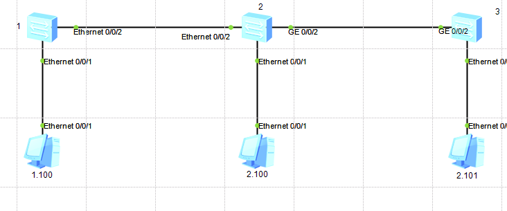

交换机不同VLAN 通信怎么让PC1ping通PC3

sysname 1
vlan batch 100 200 300
cluster enable
ntdp enable
ndp enable
drop illegal-mac alarm
diffserv domain default
drop-profile default
aaa
 authentication-scheme default
 authorization-scheme default
 accounting-scheme default
 domain default
 domain default_admin
 local-user admin password simple admin
 local-user admin service-type http
interface Vlanif1
interface Vlanif100
interface Vlanif200
 ip address 192.168.2.1 255.255.255.0
interface Vlanif300
 ip address 192.168.3.1 255.255.255.0
interface MEth0/0/1
interface Ethernet0/0/1
 port link-type access
 port default vlan 100
interface Ethernet0/0/2
 port link-type trunk
 port trunk pvid vlan 100
 port trunk allow-pass vlan 2 to 4094
interface Ethernet0/0/3
interface Ethernet0/0/4
interface Ethernet0/0/5
interface Ethernet0/0/6
interface Ethernet0/0/7
interface Ethernet0/0/8
interface Ethernet0/0/9
interface Ethernet0/0/10
interface Ethernet0/0/11
interface Ethernet0/0/12
interface Ethernet0/0/13
interface Ethernet0/0/14
interface Ethernet0/0/15
interface Ethernet0/0/16
interface Ethernet0/0/17
interface Ethernet0/0/18
interface Ethernet0/0/19
interface Ethernet0/0/20
interface Ethernet0/0/21
interface Ethernet0/0/22
interface GigabitEthernet0/0/1
interface GigabitEthernet0/0/2
interface NULL0
user-interface con 0
user-interface vty 0 4
return
sysname 2
cluster enable
ntdp enable
ndp enable
aaa
 domain default
interface Vlanif1
interface Vlanif100
interface Vlanif200
interface Vlanif300
interface MEth0/0/1
 port default vlan 200
interface NULL0
return
交换机3没有配置
交换机三
粉丝:2人 关注:0人
你三个设备都配相同的地址,肯定会冲突的,你只需要在一台设备的vlan口上配置地址就行,作为网关,其他接口做二层放通就行。
啊 我试试
倪长钰 发表时间:2023-12-27 更多>>
三台交换都配了VLAN IP PC地址段不同 不知道哪里错了
倪长钰 发表时间:2023-12-27
只能在一台上配,不能三台都配
别急_先升级 发表时间:2023-12-27
啊 我试试
倪长钰 发表时间:2023-12-27
