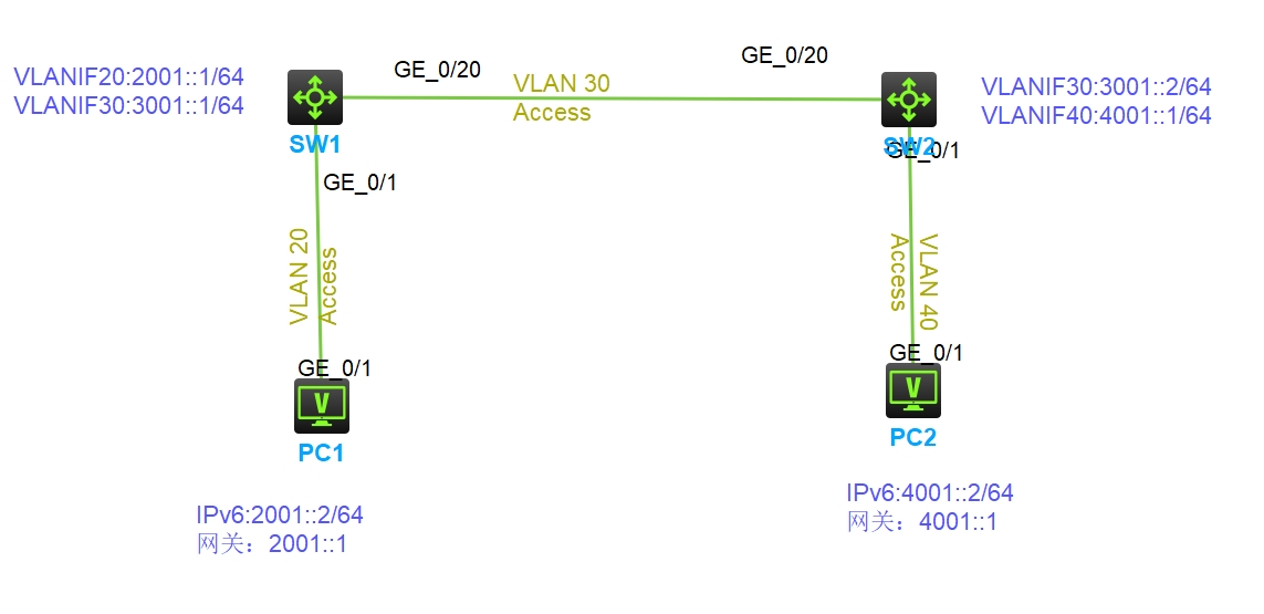

在HCL5.9.0中,做IPv6实验。为什么PC1无法ping通PC2。
2024-01-05提问
  • 0收藏,1712浏览
在本实验中,其中PC1只能Ping通SW1上的所有IP,PC2只能Ping通SW2上的所有IP。跨了一个交换机就无法Ping通了。
配置命令如下:
步骤1 在各交换机上创建VLAN并划分。
交换机 SW1:
[SW1]vlan 20
[SW1-vlan20]quit
[SW1]vlan 30
[SW1-vlan30]quit
[SW1]interface GigabitEthernet 1/0/1
[SW1-GigabitEthernet1/0/1]port link-type access
[SW1-GigabitEthernet1/0/1]port access vlan 20
[SW1-GigabitEthernet1/0/1]quit
[SW1]interface GigabitEthernet 1/0/20
[SW1-GigabitEthernet1/0/20]port link-type access
[SW1-GigabitEthernet1/0/20]port access vlan 30
[SW1-GigabitEthernet1/0/20]quit
交换机 SW2:
[SW2]vlan 30
[SW2-vlan30]quit
[SW2]vlan 40
[SW2-vlan40]quit
[SW2]interface GigabitEthernet 1/0/1
[SW2-GigabitEthernet1/0/1]port link-type access
[SW2-GigabitEthernet1/0/1]port access vlan 40
[SW2-GigabitEthernet1/0/1]quit
[SW2]interface GigabitEthernet 1/0/20
[SW2-GigabitEthernet1/0/20]port link-type access
[SW2-GigabitEthernet1/0/20]port access vlan 30
[SW2-GigabitEthernet1/0/20]quit
步骤2 配置Vlanif接口的IPv6地址。
交换机 SW1:
[SW1]interface Vlan-interface 20
[SW1-Vlan-interface20]ipv6 add 2001::1 64
[SW1-Vlan-interface20]undo ipv6 nd ra halt  //允许其发布RA消息(缺省情况下,所有的接口不会发布RA消息)
[SW1-Vlan-interface20]quit
[SW1]interface Vlan-interface 30
[SW1-Vlan-interface30]ipv6 add 3001::1 64
[SW1-Vlan-interface30]quit
交换机 SW2:
[SW2]interface Vlan-interface 30
[SW2-Vlan-interface30]ipv6 add 3001::2 64
[SW2-Vlan-interface30]quit
[SW2]interface Vlan-interface 40
[SW2-Vlan-interface40]ipv6 add 4001::1 64
[SW2-Vlan-interface40]undo ipv6 nd ra halt  //允许其发布RA消息(缺省情况下,所有的接口不会发布RA消息)
[SW2-Vlan-interface40]quit
步骤3 配置IPv6静态路由。
交换机 SW1:
[SW1]ipv6 route-static 4001:: 64 3001::2
交换机 SW2:
[SW2]ipv6 route-static 2001:: 64 3001::1

两个交换机之间的链路改成trunk

这应该是bug,联系hcl客服或者邮件联系厂家
