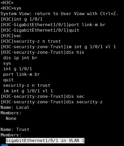

粉丝:20人 关注:9人
接口配置为trunk,然后加入安全域,剩下的就是放通安全策略就好。
以下是参考命令:
[FW1]int range gi 1/0/2 to gi 1/0/3
[FW1-if-range]port link-mode bridge
[FW1-if-range]port link-type trunk
[FW1-if-range]undo port trunk permit vlan 1
[FW1-if-range]port trunk permit vlan 10
[FW1-if-range]quit
[FW1]security-zone name Trust
[FW1-security-zone-Trust]import interface GigabitEthernet 1/0/3 vlan 10
[FW1-security-zone-Trust]quit
[FW1]security-zone name Untrust
[FW1-security-zone-Untrust]import interface GigabitEthernet 1/0/2 vlan 10
[FW1-security-zone-Untrust]quit
