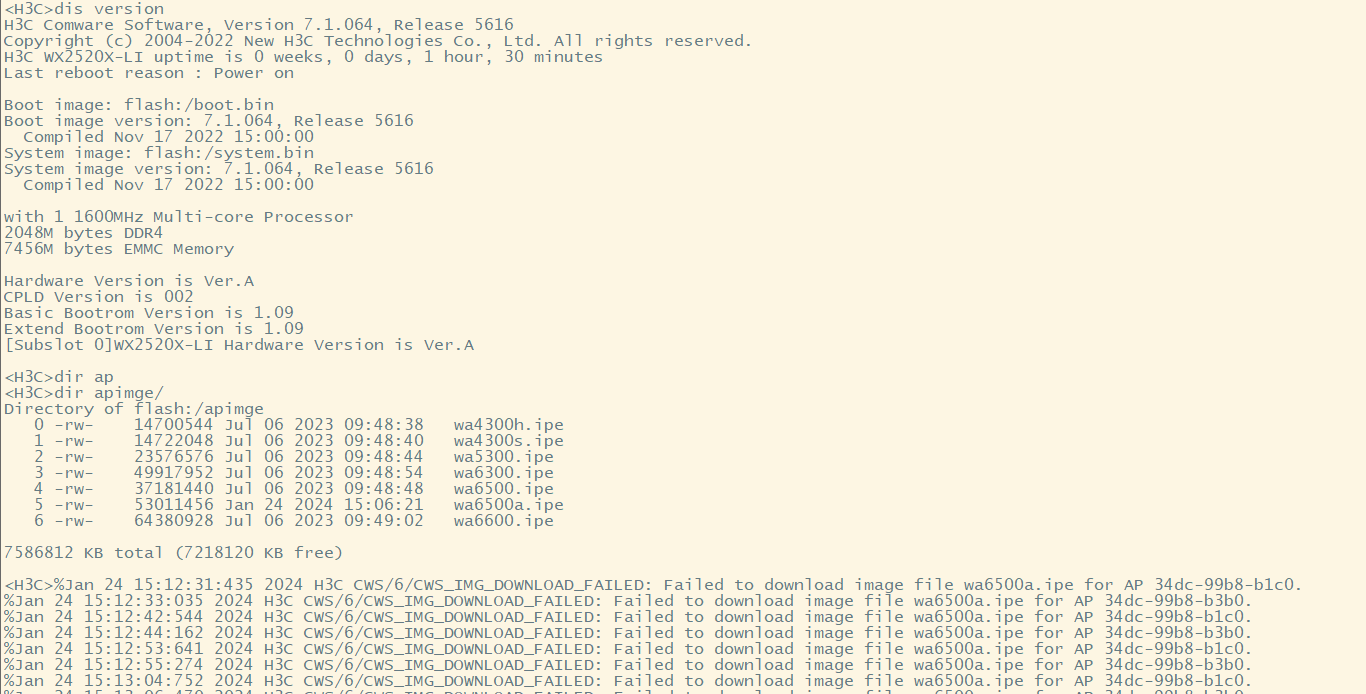

上传了最新ACzip包中的wa6500a.ipe文件到apimage中,并重启了AP,但是AC上仍然在报错???见下面我上传的图片所示
zhiliao_4uKWQ 发表时间:2024-01-24
你这是下载失败,你进APctr+f格式化下AP,
zhiliao_0049 发表时间:2024-01-24
下载失败就要么内存不够或者版本不对
<H3C>dir Directory of flash: (YAFFS2) 0 drw- - May 25 2023 00:00:00 cloud 1 drw- - May 25 2023 00:49:47 fit 2 -rw- 109 May 25 2023 00:49:46 ifindex.dat 3 -rw- 1958 May 25 2023 00:49:47 startup.cfg 4 -rw- 37509 May 25 2023 00:49:47 startup.mdb 5 -rw- 10 May 25 2023 00:00:05 userloginInfo.dat 6 -rw- 3937280 Jan 01 2020 00:00:00 wa6500a-boot.bin 7 -rw- 875520 Jan 01 2020 00:00:00 wa6500a-freeradius.bin 8 -rw- 49675264 Jan 01 2020 00:00:00 wa6500a-system.bin 112640 KB total (56156 KB free) wa6500a.ipe 51769k 2个AP都报这个错呀 AP的空间看来应该可以呀

<H3C>dis version H3C Comware Software, Version 7.1.064, Release 5616 Copyright (c) 2004-2022 New H3C Technologies Co., Ltd. All rights reserved. H3C WX2520X-LI uptime is 0 weeks, 0 days, 1 hour, 30 minutes Last reboot reason : Power on Boot image: flash:/boot.bin Boot image version: 7.1.064, Release 5616 Compiled Nov 17 2022 15:00:00 System image: flash:/system.bin System image version: 7.1.064, Release 5616 Compiled Nov 17 2022 15:00:00 with 1 1600MHz Multi-core Processor 2048M bytes DDR4 7456M bytes EMMC Memory Hardware Version is Ver.A CPLD Version is 002 Basic Bootrom Version is 1.09 Extend Bootrom Version is 1.09 [Subslot 0]WX2520X-LI Hardware Version is Ver.A <H3C>dir ap <H3C>dir apimge/ Directory of flash:/apimge 0 -rw- 14700544 Jul 06 2023 09:48:38 wa4300h.ipe 1 -rw- 14722048 Jul 06 2023 09:48:40 wa4300s.ipe 2 -rw- 23576576 Jul 06 2023 09:48:44 wa5300.ipe 3 -rw- 49917952 Jul 06 2023 09:48:54 wa6300.ipe 4 -rw- 37181440 Jul 06 2023 09:48:48 wa6500.ipe 5 -rw- 53011456 Jan 24 2024 15:06:21 wa6500a.ipe 6 -rw- 64380928 Jul 06 2023 09:49:02 wa6600.ipe 7586812 KB total (7218120 KB free) <H3C>%Jan 24 15:12:31:435 2024 H3C CWS/6/CWS_IMG_DOWNLOAD_FAILED: Failed to download image file wa6500a.ipe for AP 34dc-99b8-b1c0. %Jan 24 15:12:33:035 2024 H3C CWS/6/CWS_IMG_DOWNLOAD_FAILED: Failed to download image file wa6500a.ipe for AP 34dc-99b8-b3b0. %Jan 24 15:12:42:544 2024 H3C CWS/6/CWS_IMG_DOWNLOAD_FAILED: Failed to download image file wa6500a.ipe for AP 34dc-99b8-b1c0. %Jan 24 15:12:44:162 2024 H3C CWS/6/CWS_IMG_DOWNLOAD_FAILED: Failed to download image file wa6500a.ipe for AP 34dc-99b8-b3b0. %Jan 24 15:12:53:641 2024 H3C CWS/6/CWS_IMG_DOWNLOAD_FAILED: Failed to download image file wa6500a.ipe for AP 34dc-99b8-b1c0. %Jan 24 15:12:55:274 2024 H3C CWS/6/CWS_IMG_DOWNLOAD_FAILED: Failed to download image file wa6500a.ipe for AP 34dc-99b8-b3b0. 我已经上传了wa6500a.ipe文件,并重启了AP,为啥还报错?
