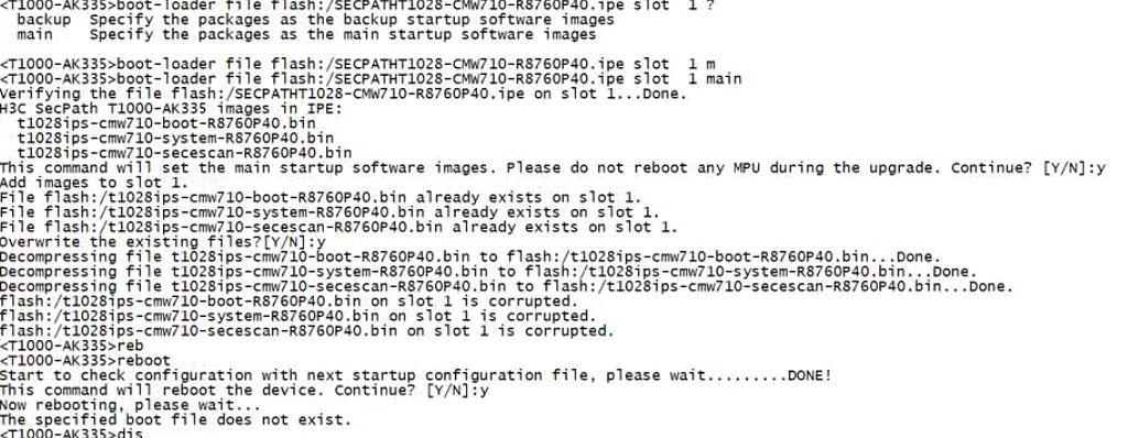

不好意思,是无法重启,提示特殊文件丢失。
这是个新设备,新设备提示固件丢失,我从新下载一个固件升级一下看行不行。
官方只有1个升级固件,也无法升级
官方只有要给升级固件,也有问题无法升级, <T1000-AK335>boot-loader file flash:/SECPATHT1028-CMW710-R8760P40.ipe ? all Set the startup software image for all the slot slot Specify the slot <T1000-AK335>boot-loader file flash:/SECPATHT1028-CMW710-R8760P40.ipe s <T1000-AK335>boot-loader file flash:/SECPATHT1028-CMW710-R8760P40.ipe slot 1 ? backup Specify the packages as the backup startup software images main Specify the packages as the main startup software images <T1000-AK335>boot-loader file flash:/SECPATHT1028-CMW710-R8760P40.ipe slot 1 m <T1000-AK335>boot-loader file flash:/SECPATHT1028-CMW710-R8760P40.ipe slot 1 main Verifying the file flash:/SECPATHT1028-CMW710-R8760P40.ipe on slot 1...Done. H3C SecPath T1000-AK335 images in IPE: t1028ips-cmw710-boot-R8760P40.bin t1028ips-cmw710-system-R8760P40.bin t1028ips-cmw710-secescan-R8760P40.bin This command will set the main startup software images. Please do not reboot any MPU during the upgrade. Continue? [Y/N]:y Add images to slot 1. File flash:/t1028ips-cmw710-boot-R8760P40.bin already exists on slot 1. File flash:/t1028ips-cmw710-system-R8760P40.bin already exists on slot 1. File flash:/t1028ips-cmw710-secescan-R8760P40.bin already exists on slot 1. Overwrite the existing files?[Y/N]:y Decompressing file t1028ips-cmw710-boot-R8760P40.bin to flash:/t1028ips-cmw710-boot-R8760P40.bin...Done. Decompressing file t1028ips-cmw710-system-R8760P40.bin to flash:/t1028ips-cmw710-system-R8760P40.bin...Done. Decompressing file t1028ips-cmw710-secescan-R8760P40.bin to flash:/t1028ips-cmw710-secescan-R8760P40.bin...Done. flash:/t1028ips-cmw710-boot-R8760P40.bin on slot 1 is corrupted. flash:/t1028ips-cmw710-system-R8760P40.bin on slot 1 is corrupted. flash:/t1028ips-cmw710-secescan-R8760P40.bin on slot 1 is corrupted. <T1000-AK335>
