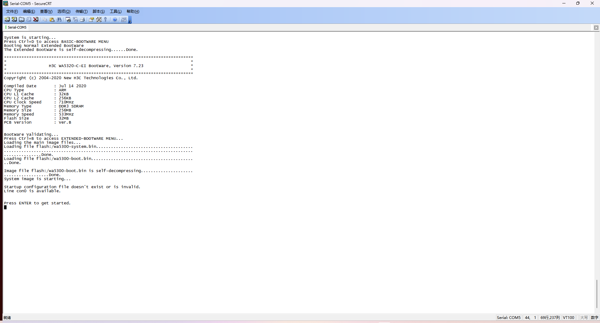

System is starting... Press Ctrl+D to access BASIC-BOOTWARE MENU Booting Normal Extended BootWare The Extended BootWare is self-decompressing......Done. **************************************************************************** * * * H3C WA5320-C-EI BootWare, Version 7.23 * * * **************************************************************************** Copyright (c) 2004-2020 New H3C Technologies Co., Ltd. Compiled Date : Jul 14 2020 CPU Type : ARM CPU L1 Cache : 32KB CPU L2 Cache : 256KB CPU Clock Speed : 710MHz Memory Type : DDR3 SDRAM Memory Size : 256MB Memory Speed : 533MHz Flash Size : 32MB PCB Version : Ver.B BootWare Validating... Press Ctrl+B to access EXTENDED-BOOTWARE MENU... Loading the main image files... Loading file flash:/wa5300-system.bin....................................... ............................................................................ ...............Done. Loading file flash:/wa5300-boot.bin......................................... ..Done. Image file flash:/wa5300-boot.bin is self-decompressing..................... ..................Done. System image is starting...

现在橙灯常亮了
zhiliao_OWAeBP 发表时间:2024-01-31
能进到命令行吗
返璞归真 发表时间:2024-01-31
敲了回车没反应就是显示这些命令
在下方如图
