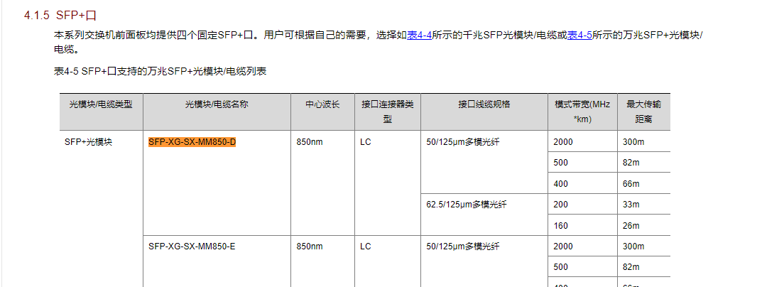

S5560X-54F-EI安装了 SFP-XG-SX-MM850-D 光模块,2交换机相连反复端口关闭开启,
%Jan  4 02:05:27:120 2021 H3C IFNET/3/PHY_UPDOWN: Physical state on the interface Ten-GigabitEthernet1/0/49 changed to down.
%Jan  4 02:05:27:127 2021 H3C IFNET/5/LINK_UPDOWN: Line protocol state on the interface Ten-GigabitEthernet1/0/49 changed to down.
%Jan  4 02:05:27:186 2021 H3C IFNET/3/PHY_UPDOWN: Physical state on the interface Ten-GigabitEthernet1/0/49 changed to up.
%Jan  4 02:05:27:192 2021 H3C IFNET/5/LINK_UPDOWN: Line protocol state on the interface Ten-GigabitEthernet1/0/49 changed to up.
%Jan  4 02:05:27:317 2021 H3C IFNET/3/PHY_UPDOWN: Physical state on the interface Ten-GigabitEthernet1/0/49 changed to down.
%Jan  4 02:05:27:318 2021 H3C IFNET/5/LINK_UPDOWN: Line protocol state on the interface Ten-GigabitEthernet1/0/49 changed to d
是不兼容 吗?

兼容,看下收发光是不是中间链路有问题
