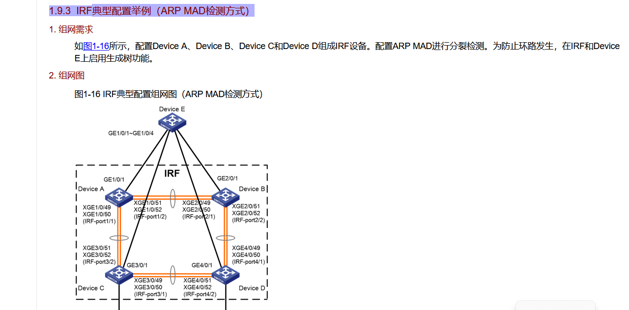

4台设备做IRF堆叠,BFD检测怎做没有中间设备??????
sw1------sw2
sw3------sw3

1.9.3  IRF典型配置举例(ARP MAD检测方式)
https://www.h3c.com/cn/d_202305/1857872_30005_0.htm#_Toc136219043

如图1-15所示,配置Device A、Device B、Device C和Device D组成IRF设备。配置BFD MAD进行分裂检测。
2. 组网图
图1-15 IRF典型配置组网图(BFD MAD检测方式)

(8)     配置BFD MAD
# 创建VLAN 3,并将端口GigabitEthernet1/0/1、GigabitEthernet2/0/1、GigabitEthernet3/0/1和GigabitEthernet4/0/1加入VLAN 3中。
[Sysname] vlan 3
[Sysname-vlan3] port gigabitethernet 1/0/1 gigabitethernet 2/0/1 gigabitethernet 3/0/1 gigabitethernet 4/0/1
[Sysname-vlan3] quit
# 创建VLAN接口3,并配置MAD IP地址。
[Sysname] interface vlan-interface 3
[Sysname-Vlan-interface3] mad bfd enable
[Sysname-Vlan-interface3] mad ip address 192.168.2.1 24 member 1
[Sysname-Vlan-interface3] mad ip address 192.168.2.2 24 member 2
[Sysname-Vlan-interface3] mad ip address 192.168.2.3 24 member 3
[Sysname-Vlan-interface3] mad ip address 192.168.2.4 24 member 4
[Sysname-Vlan-interface3] quit
# 因为BFD MAD和生成树功能互斥,所以在GigabitEthernet1/0/1、GigabitEthernet2/0/1、GigabitEthernet3/0/1和GigabitEthernet4/0/1端口上关闭生成树协议。
[Sysname] interface range gigabitethernet 1/0/1 gigabitethernet 2/0/1 gigabitethernet 3/0/1 gigabitethernet 4/0/1
[Sysname-if-range] undo stp enable
[Sysname-if-range] quit
(9)     配置中间设备Device E
Device E作为中间设备来透传BFD MAD报文,协助IRF中的四台成员设备进行多Active检测。
# 创建VLAN 3,并将端口GigabitEthernet1/0/1~GigabitEthernet1/0/4加入VLAN 3中,用于转发BFD MAD报文。
<DeviceE> system-view
[DeviceE] vlan 3
[DeviceE-vlan3] port gigabitethernet 1/0/1 to gigabitethernet 1/0/4
[DeviceE-vlan3] quit
