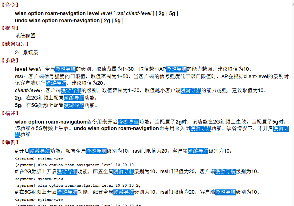

option roam-navigation enable rssi 20 beacon-power 10 probe-response-power 10
[CG.HSJ-AC-S-1-H3CWX6112E-wlan-ap-nyyhwxfh_7f_hys10-radio-1]option roam-navigation enable rssi 20 beacon-power 10 probe-respon
se-power 10
The operation is not supported.
V5的设备吧,不支持
没有这个命令
zhiliao_sEUyB 发表时间:2024-03-15 更多>>
V7
zhiliao_9KJOL 发表时间:2024-03-15
https://www.h3c.com/cn/Service/Document_Software/Document_Center/Wlan/WX/WX6100E/?category=125028
没有这个命令
您好,升级版本到最新再试试
