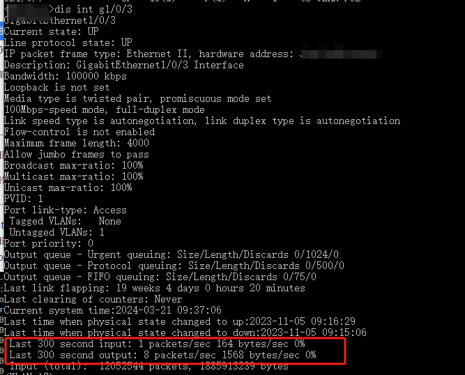

直接dis接口就可以

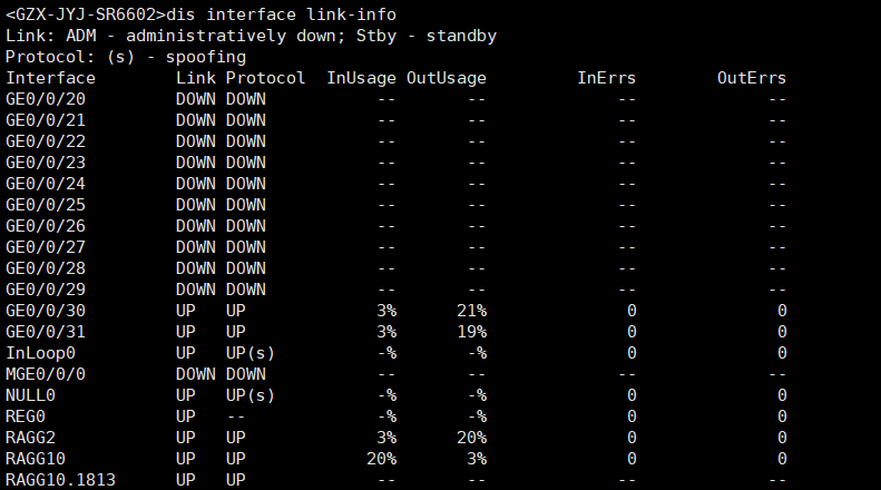

dis interface link-info

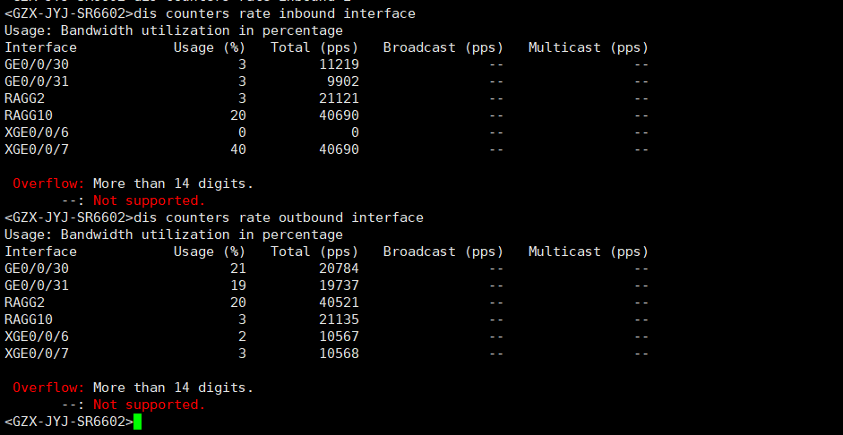

或者dis counters rate outbound interface
dis counters rate inbound interface
粉丝:1人 关注:1人
[HX]dis counters inbound interface //查看进入各个端口的流量
[HX]display counters outbound interface //查看各个出去端口的流量
display counters rate inbound interface //查看各个端口进入端口流量占用端口的百分比
display counters rate outbound interface //查看各个端口端口发出流量占用端口的百分比
[HX]disp int link-info
Link: ADM - administratively down; Stby - standby
Protocol: (s) - spoofing
Interface Link Protocol InUsage OutUsage InErrs OutErrs
BAGG1 DOWN DOWN -- -- -- --
GE1/0/1 UP UP 10% 0% 0 0
GE1/0/2 UP UP 15% 0% 0 0
