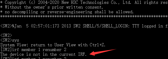

S5500 堆叠提示 irf member 1 renumber 2
2024-03-29提问
  • 1收藏,2924浏览
啊文 零段
输入irf member 1 renumber 2
提示The device is not in the current IRF.
粉丝:21人 关注:11人
建议dis cu | in member  #来确认下当前irf member id
最后 irf member id renumber 1即可还原默认状态了。
[SW2]dis this # sysname SW2 # irf mac-address persistent timer irf auto-update enable undo irf link-delay #Current IRF priority configuration # irf member 2 priority 1 #New IRF priority configuration irf member 1 priority 1 #

[SW2]dis cu | in member
