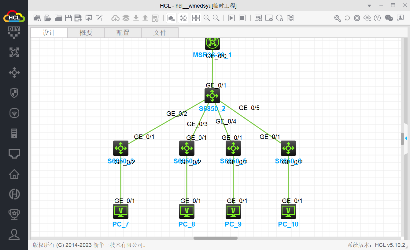

路由器交换机 一个地池怎么给几个vlan分配地址?

一般来说不同vlan不能用同网段地址,所以不同vlan没法共用地址池的
您好,以下是交换机VLAN和DHCP的配置脚本,请参考:
将交换机的名字修改为SW1:
[H3C]sysname SW1
在交换机分别创建VLAN 10、VLAN 20:
[SW1]vlan 10
[SW1-vlan10]quit
[SW1]vlan 20
[SW1-vlan20]quit
VLAN 10的IP设置为:192.168.10.1 255.255.255.0:
[SW1]int vlan 10
[SW1-Vlan-interface10]ip address 192.168.10.1 24
[SW1-Vlan-interface10]quit
VLAN 20的IP设置为:192.168.20.1 255.255.255.0:
[SW1]int vlan 20
[SW1-Vlan-interface20]ip address 192.168.20.1 24
[SW1-Vlan-interface20]quit
将GI1/0/1端口划分到VLAN 10:
[SW1]int gi 1/0/1
[SW1-GigabitEthernet1/0/1]port link-type access
[SW1-GigabitEthernet1/0/1]port access vlan 10
[SW1-GigabitEthernet1/0/1]quit
将GI1/0/2端口划分到VLAN 20:
[SW1]int gi 1/0/2
[SW1-GigabitEthernet1/0/2]port link-type access
[SW1-GigabitEthernet1/0/2]port access vlan 20
[SW1-GigabitEthernet1/0/2]quit
开启DHCP功能:
[SW1]dhcp enable
创建DHCP地址池,命名为VLAN10,分配网段、子网掩码、默认网关、DNS:
[SW1]dhcp server ip-pool vlan10
[SW1-dhcp-pool-vlan10]network 192.168.10.0 mask 255.255.255.0
[SW1-dhcp-pool-vlan10]gateway-list 192.168.10.1
[SW1-dhcp-pool-vlan10]dns-list 114.114.114.114
[SW1-dhcp-pool-vlan10]quit
[SW1]
创建DHCP地址池,命名为VLAN20,分配网段、子网掩码、默认网关、DNS:
[SW1]dhcp server ip-pool vlan20
[SW1-dhcp-pool-vlan20]network 192.168.20.0 mask 255.255.255.0
[SW1-dhcp-pool-vlan20]gateway-list 192.168.20.1
[SW1-dhcp-pool-vlan20]dns-list 114.114.114.114
[SW1-dhcp-pool-vlan20]quit
粉丝:64人 关注:2人
是几个vlan 公用第一个地址池是吧。
你可以采用dhcp中继的方式去实现
Admin 四段
粉丝:11人 关注:0人
多个vlan 使用同一个地址池?
这有什么意义呢
